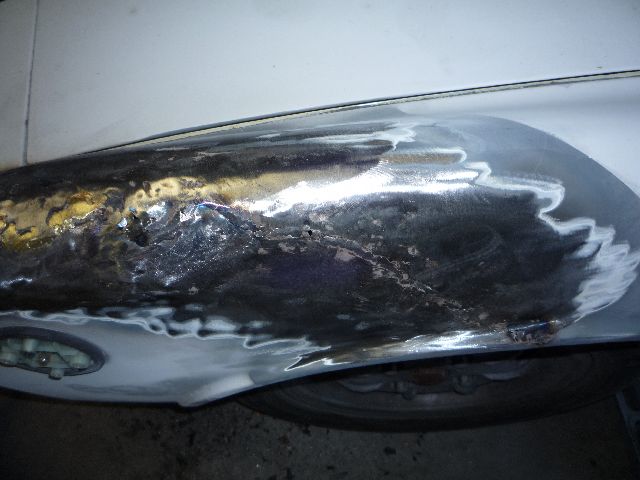

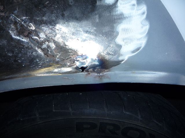

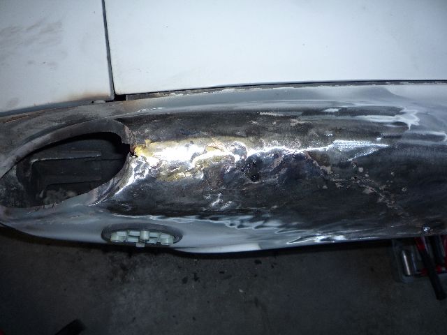

Okay I went to home depot & got the Mapps just like in the photo above. It works great for loosening everything up. Got it bubbling then used a screwdriver to scrap the filler off. IT was very thick in places. I would say 3/8 of an inch in spot (IMG:style_emoticons/default/WTF.gif) . I also went to harbor freight yesterday for the body hammer & tools. I forgot to take pics before I went to work on it. IT went pretty well & I can see I should be able to get things pretty close. I will definately need finish work by a pro but mostly because of the weld mixed in. I'm not sure how but it looks like it cracked in a long line? Was cut? Anyway there is some weld from just above the tire forward. Then there is a break with some brass weld(?) just above the front turn signal.
Anyone have a trick for getting the top of the fender hammered up some. I can't seem to get up there with the hammer or the small anvils. Also the area below the turn signal is bent down a bit. I don't see how to get up there without some long extension to hammer.
I also took it for a 50 mile ride this morning. Drives pretty good but could use a tuneup. Clutch felt good as did the shift linkage. Going to treat the rust in the rear trunk tonight (IMG:style_emoticons/default/dry.gif)
