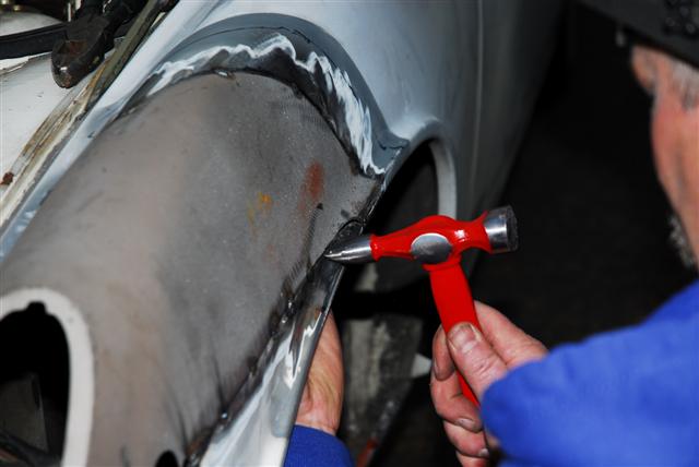

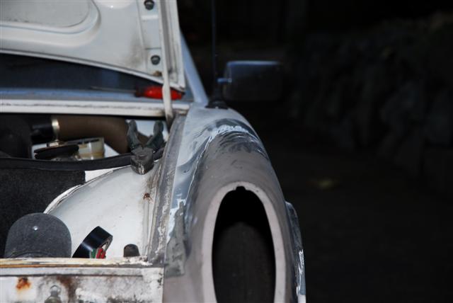

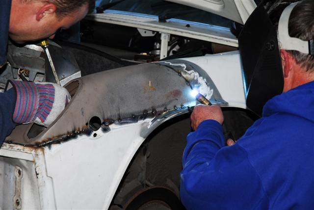

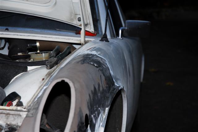

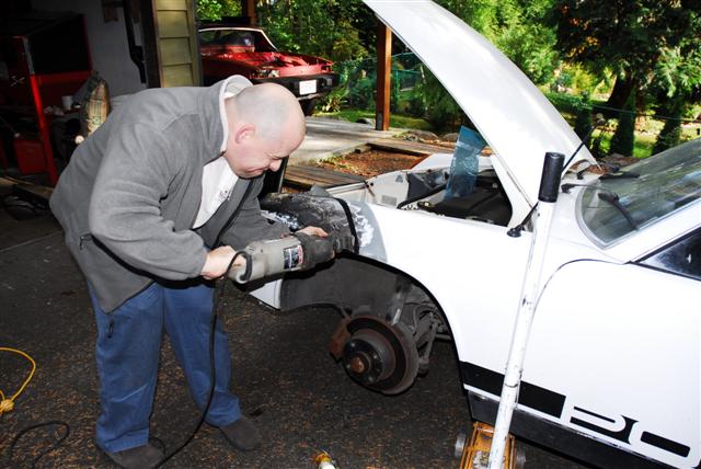

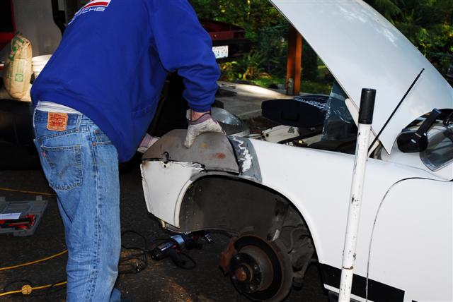

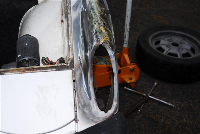

Okay so I got the fender cutout & replaced thanks to the seattle Work party. Jeff Hines is the man. Between him & Dan Root they got the fender on & very nice. We decided it would be better to replace the area rather than fix it as it was just to hammered. Although we were able to keep all the factory welds in place. It turned out great! I'll need a small amount of filler but just a very small amount. Here are some pics (thanks to John Bovey as I forgot my dang camera).

jd74914   Its really not that hard. The same fender on our n...   Oct 16 2008, 07:14 AM
JRust   What is the best way to get the filler on there ou...   Oct 16 2008, 08:15 PM
scotty b   What is the best way to get the filler on there o...   Oct 16 2008, 08:20 PM
JRust   B)-->
QUOTE(scotty b @ O...   Oct 17 2008, 09:00 PM
scotty b   B)--><div class='quotetop'>QUOT...   Oct 17 2008, 09:12 PM
computers4kids   Jamie...remember this fender, you should...you hel...   Oct 16 2008, 11:14 PM
JRust   Ohhhhhtay! I'll go to harbor freight tommo...   Oct 17 2008, 12:06 AM
JRust   Okay I went to home depot & got the Mapps just...   Oct 18 2008, 07:41 PM
scotty b   That kinda sucks. It has quite obviously had a cli...   Oct 18 2008, 09:08 PM
JRust   I don't think it had a spliced section. I real...   Oct 19 2008, 12:01 AM
scotty b   I don't think it had a spliced section. I rea...   Oct 19 2008, 09:31 AM
computers4kids   I knew you could do it! :smash: Great step in ...   Oct 19 2008, 01:35 AM
