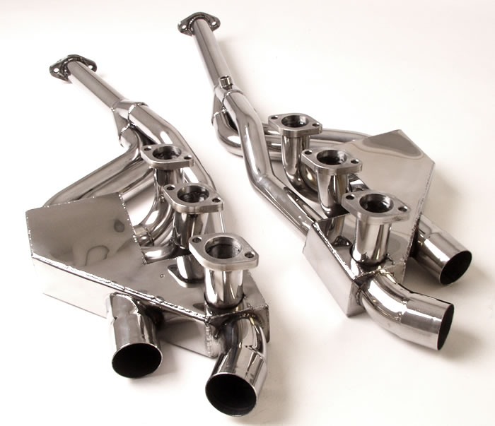

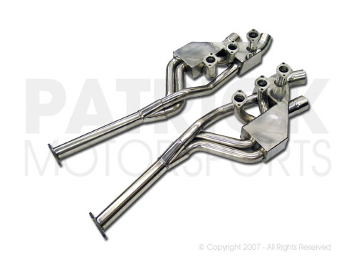

"Luftecnic", SSI distributors here on the East Coast, called back & confirmed there are no SSI exchangers for the six. Best looking ones are either Patrick or B&B. Only difference I can see is the O2 bunghole. GHL ones do not look very good. Photo order is Patrick, GHL & B&B.

9146986   B&B makes some, but 3 out of 4 sets won't ...   Oct 27 2008, 11:31 AM
Johny Blackstain   B&B makes some, but 3 out of 4 sets won't...   Oct 27 2008, 12:39 PM
9146986   Here's a pic from the GHL website, the heater ...   Oct 27 2008, 11:49 AM
J P Stein   Here's a pic from the GHL website, the heater...   Oct 27 2008, 12:07 PM

Johny Blackstain   The Patrick Motorsports is the Billy Boat. There...   Oct 27 2008, 05:34 PM
number6   The Patrick Motorsports is the Billy Boat. There...   Oct 27 2008, 05:43 PM

9146986   The Hayward & Scott have welds inside the heat...   Oct 27 2008, 11:41 PM
number6   The Hayward & Scott have welds inside the hea...   Oct 28 2008, 04:29 AM
SirAndy   The Hayward & Scott have welds inside the he...   Oct 28 2008, 12:52 PM
