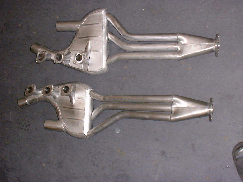

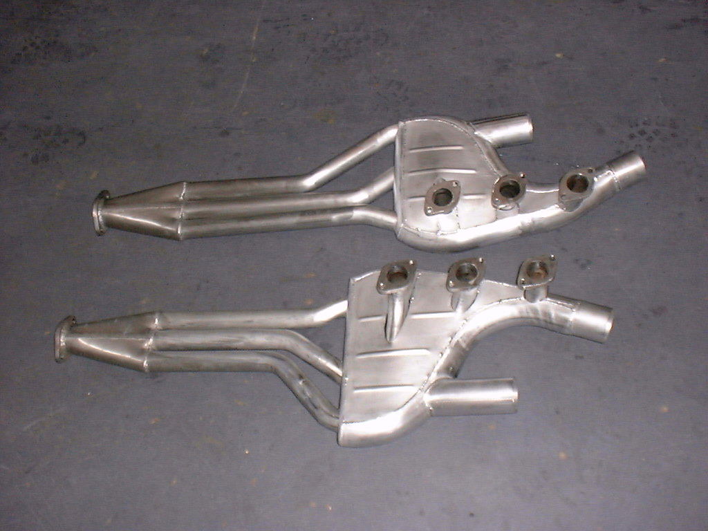

Well, apparently I did, indirectly. This is the response I just received, along with 2 larger photos, attached:
Do you have 914 / 6 ? just wondered as you also mentioned a 3.2 but are
you transplanting the engine into the 914 ?. As for supercharging the
pipes would be far to small as standard ( 1.5" OD ) even for a 3.2 but
if you go ahead with the order and mention at the time we would enlarge
the pipes to accept the additional power ( 1.75" OD ). They are made
from BS304 16 SWG through out and the heat exchangers work very well
and we haven't had a complaints. :-) .
lead time at the moment is approx 4 -6 weeks and if you can give me your
full address we can get you a shipping price.
Thank you
Ian Reeve
Manager

number6   A follow-up response: Yes we can make them in whi...   Oct 28 2008, 03:01 PM

number6   From Hayward & Scott, in response to my inquir...   Oct 29 2008, 03:47 AM

amallagh   I bought a set of the H&S heat exchangers in D...   Feb 9 2010, 03:17 PM
dr914@autoatlanta.com   Here is a picture of the four cylinder heat exchan...   Feb 9 2010, 05:00 PM
