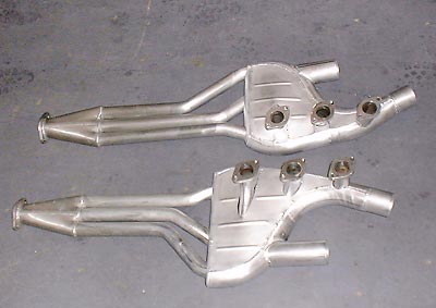

I'm not 18 anymore & require heat in my car. I bought my six off the 914world classifieds 2 yrs ago & have found the car to be a blast, except in the winter. Very good for the air cooled engine, very bad for my bones. Obviously I have headers & I love the power, torque & sound I get out of them. I'd like to presume that the original heat exchangers were removed for the number 1 reason here on the East Coast... RUST & $COST$. I can live w/out A/C, but heat is a must. Suggestions? The six is sporting a high compression 2.7.

Or the Hayword and Scott. Which might be a pain to get to the flange nuts.
http://www.haywardandscott.com/Details.asp...amp;category=16
I have the stock HE's but have found that they dont work all that great with the turbo.

Chappy, what is the OD of the stock HEs? How is the smaller pipe affecting your turbo setup? Is it insufficient at high boost, or any boost level?
Do you think the stock HEs would be ok for a NA 3.2? If so, and you ever decide to sell yours, please keep me in mind! (IMG:style_emoticons/default/smile.gif)

9146986   Here's a pic from the GHL website, the heater ...   Oct 27 2008, 11:49 AM
J P Stein   Here's a pic from the GHL website, the heater...   Oct 27 2008, 12:07 PM

9146986   The Hayward & Scott have welds inside the heat...   Oct 27 2008, 11:41 PM
number6   The Hayward & Scott have welds inside the hea...   Oct 28 2008, 04:29 AM
SirAndy   The Hayward & Scott have welds inside the he...   Oct 28 2008, 12:52 PM

number6   A follow-up response: Yes we can make them in whi...   Oct 28 2008, 03:01 PM
Eric_Shea   Andy, Whay I think Perry is referring to is havin...   Oct 28 2008, 03:29 PM
Lavanaut   If there is a weld that is contained within that ...   Oct 28 2008, 04:59 PM
Root_Werks   If there is a weld that is contained within that...   Oct 28 2008, 05:03 PM
iamchappy   Stock HE's will work with the 3.2 ok, i know t...   Oct 28 2008, 05:16 PM
number6   From Hayward & Scott, in response to my inquir...   Oct 29 2008, 03:47 AM
Eric_Shea   If anything is wrong or goes wrong with that wel...   Oct 29 2008, 08:29 AM
