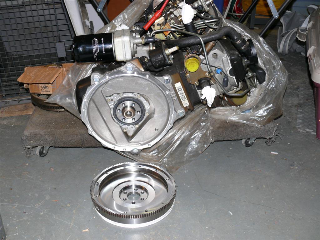

I found a 73 914 in good condition in July 2006. The intention from day one was to convert this car to electric or diesel.
The car had been stored for 19 years. I had to do the typical flush the gas tank rebuild the calipers etc. I put a hundred miles or so on the motor that was in the car and then it sat for a few months while I started gathering up information to do an EV
conversion. The numbers for weight and range just didn't add up for my requirements so a diesel conversion was decided on. Now I just hope to get it running before we run out of oil.

Where did you get your adapter plate? Or did you fab it yourself? Can you please let us know what it took to match the engine to the trans.
I have dropped a 1.6 TD into my Suzuki Samurai and I love it. It would be cool to have one in my 914 also.
Jim
kennedy adapter. They modified my flywheel.

Bill D   I have the engine in place with a fabricated front...   Aug 13 2008, 01:28 PM
Bill D   Some pics of the slow progress   Aug 13 2008, 04:52 PM
type11969   Bill - How much was the engine and where did you p...   Aug 13 2008, 05:15 PM
Bill D   I purchased the engine from VW a few years ago. It...   Aug 13 2008, 06:23 PM
