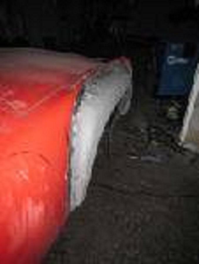

Here is one re-sized: Not pretty.

Chuck   How did you get the bottoms to fit? I've seen ...   Nov 10 2008, 08:49 PM
Root_Werks   How did you get the bottoms to fit? I've seen...   Nov 10 2008, 09:41 PM
Chuck   How did you get the bottoms to fit? I've see...   Nov 10 2008, 11:14 PM

pete-stevers   [quote name='Root_Werks' post='1100810' date='Nov...   Nov 11 2008, 12:50 AM
pete-stevers   what i can see is you set the flare where it fits ...   Nov 11 2008, 12:55 AM

pete-stevers   Had a chance to get out to the shop today ground d...   Nov 13 2008, 07:50 PM
charliew   Looks great. Did you guys use the easy grind type ...   Nov 14 2008, 12:54 PM
Root_Werks   Looks great. Did you guys use the easy grind type...   Nov 14 2008, 01:35 PM
PanelBilly   Put a few hours into metal work....well may more ...   Nov 14 2008, 02:13 PM
pete-stevers   i believe dan has the answer to the for-aft of the...   Nov 14 2008, 02:52 PM
maf914   Dan, Thanks for sharing your technique, tack at t...   Nov 14 2008, 03:27 PM
PanelBilly   The top of the flare is below the top of the fende...   Nov 14 2008, 04:34 PM
Root_Werks   Yup, the biggest thing is getting the bottom edges...   Nov 14 2008, 05:08 PM

pete-stevers   here is a shot of the car with a bit of filler on ...   Dec 13 2008, 10:24 PM
pete-stevers   once i got most of the shaping done, with many gui...   Dec 13 2008, 10:31 PM

pete-stevers   for all the taping and prep i could have almost pa...   Dec 14 2008, 11:49 AM

PanelBilly   How did the underside turn out? Are you planning o...   Dec 14 2008, 04:37 PM
pete-stevers   i sprayed the welds with etch coat, and k201, next...   Dec 14 2008, 04:52 PM

pete-stevers   pardon me..the primer was a PPG k38 the primer was...   Dec 15 2008, 06:43 PM

pete-stevers   my opinions on the sanding so far...it is tough to...   Dec 16 2008, 12:51 PM

pete-stevers   i am planning to do the final block with 800 wet I...   Jan 14 2009, 05:19 PM

pete-stevers   i have finished blocking the second layer of prime...   Jan 26 2009, 08:51 PM

pete-stevers   Well i got a little farther today sprayed a layer ...   Jan 30 2009, 08:09 PM
pete-stevers   this is the quarater that caused the most trouble ...   Jan 30 2009, 08:11 PM
pete-stevers   and here is my big bad...can't even look at sc...   Jan 30 2009, 08:14 PM

pete-stevers   toughest part so far is the filling,puttying and b...   Jan 30 2009, 08:25 PM
