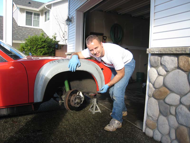

I got home Saturday just around noonish and notice this hanging out at my house:

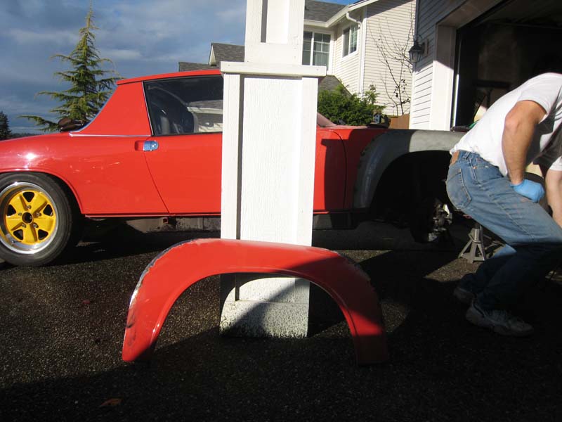

Root_Werks   Next thing I know, Steve Peters is pulling flares ...   Nov 9 2008, 07:09 PM
Root_Werks   By one-o-clock, we had already made our first fitt...   Nov 9 2008, 07:10 PM

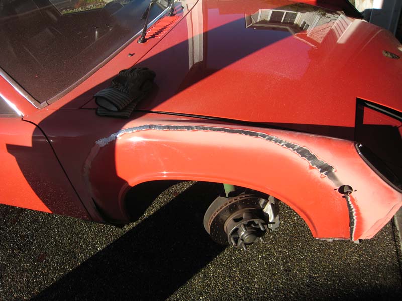

Chuck   How did you get the bottoms to fit? I've seen ...   Nov 10 2008, 08:49 PM
Root_Werks   How did you get the bottoms to fit? I've seen...   Nov 10 2008, 09:41 PM
Chuck   How did you get the bottoms to fit? I've see...   Nov 10 2008, 11:14 PM

pete-stevers   [quote name='Root_Werks' post='1100810' date='Nov...   Nov 11 2008, 12:50 AM
pete-stevers   what i can see is you set the flare where it fits ...   Nov 11 2008, 12:55 AM
