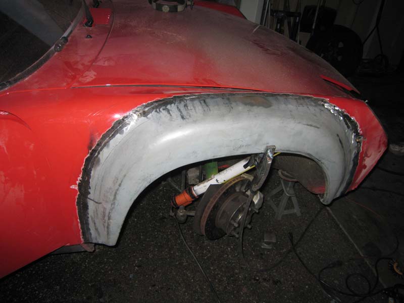

here is the one you are looking for dan...once the welds where ground down it is almost as smooth as.....

Chuck   How did you get the bottoms to fit? I've seen ...   Nov 10 2008, 08:49 PM
Root_Werks   How did you get the bottoms to fit? I've seen...   Nov 10 2008, 09:41 PM

pete-stevers   [quote name='Root_Werks' post='1100810' date='Nov...   Nov 11 2008, 12:50 AM
pete-stevers   what i can see is you set the flare where it fits ...   Nov 11 2008, 12:55 AM

pete-stevers   Had a chance to get out to the shop today ground d...   Nov 13 2008, 07:50 PM
charliew   Looks great. Did you guys use the easy grind type ...   Nov 14 2008, 12:54 PM
Root_Werks   Looks great. Did you guys use the easy grind type...   Nov 14 2008, 01:35 PM
PanelBilly   Put a few hours into metal work....well may more ...   Nov 14 2008, 02:13 PM
pete-stevers   i believe dan has the answer to the for-aft of the...   Nov 14 2008, 02:52 PM
maf914   Dan, Thanks for sharing your technique, tack at t...   Nov 14 2008, 03:27 PM
PanelBilly   The top of the flare is below the top of the fende...   Nov 14 2008, 04:34 PM
Root_Werks   Yup, the biggest thing is getting the bottom edges...   Nov 14 2008, 05:08 PM
