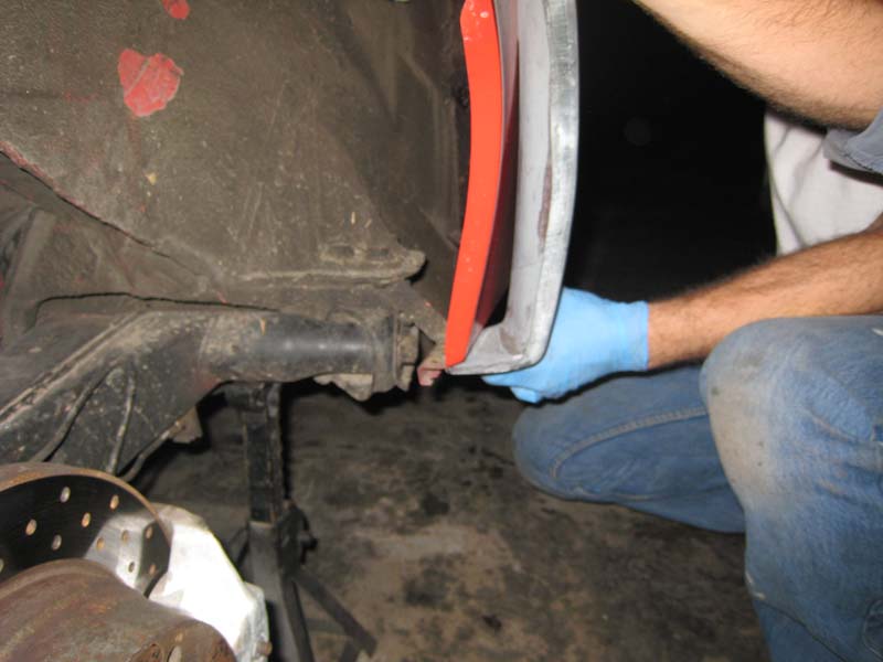

I got home Saturday just around noonish and notice this hanging out at my house:

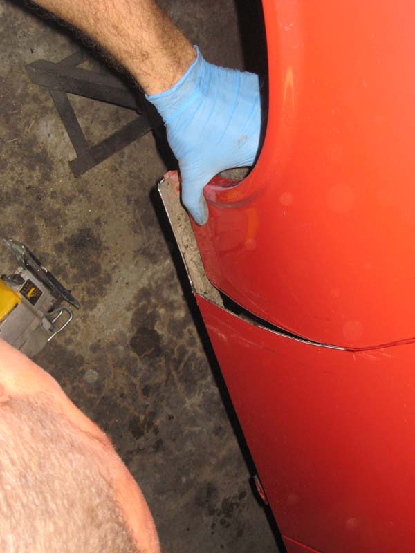

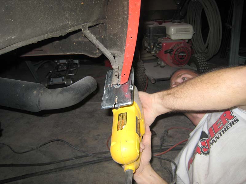

Chuck   How did you get the bottoms to fit? I've seen ...   Nov 10 2008, 08:49 PM
Root_Werks   How did you get the bottoms to fit? I've seen...   Nov 10 2008, 09:41 PM
Chuck   How did you get the bottoms to fit? I've see...   Nov 10 2008, 11:14 PM

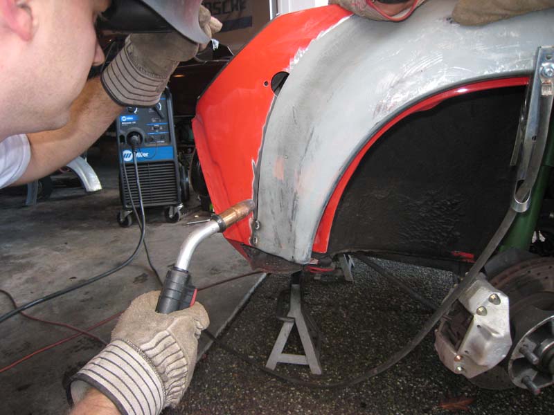

Root_Werks   Yup, the biggest thing is getting the bottom edges...   Nov 14 2008, 05:08 PM
