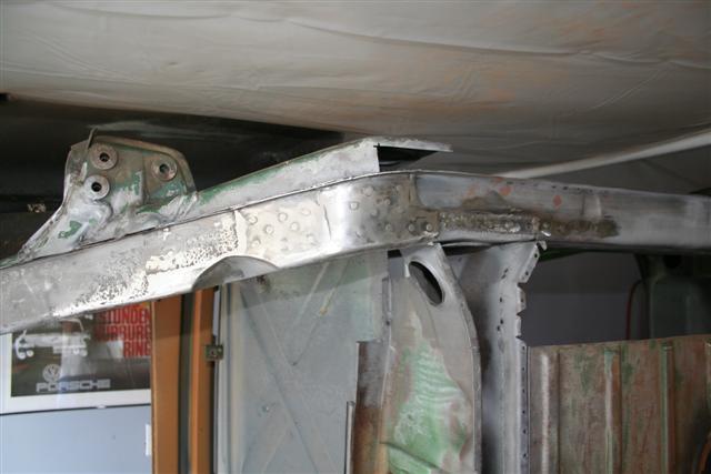

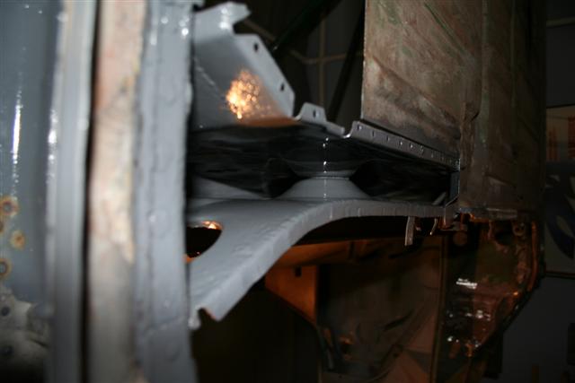

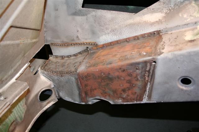

It has been quite awhile since I have updated this thread. Here is some progress over the late summer and early fall.
Welded in the replacement skin for the area directly behind the 4-cyl engine mount. Also part of the suspension console covers this.

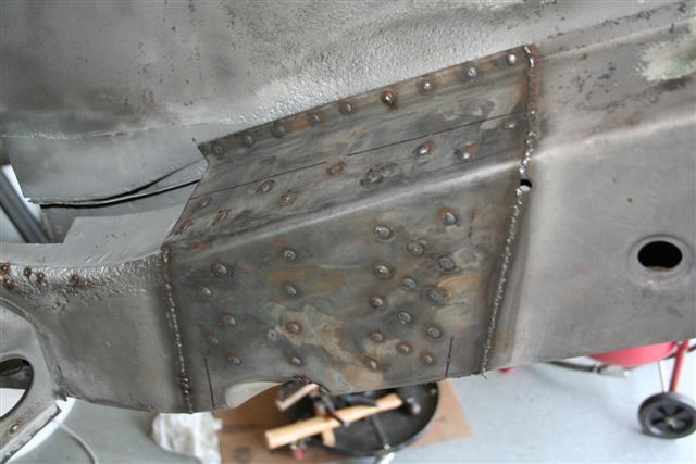

View from below. I will do some final grinding of welds when doing prep for paint.

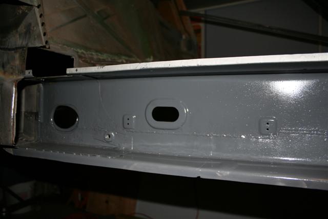

Working toward finishing the passenger longitudinal. Here I have painted the interior with POR-15.
More POR-15, but this is a shot from under the car into the hollow bulkhead behind the seats.
