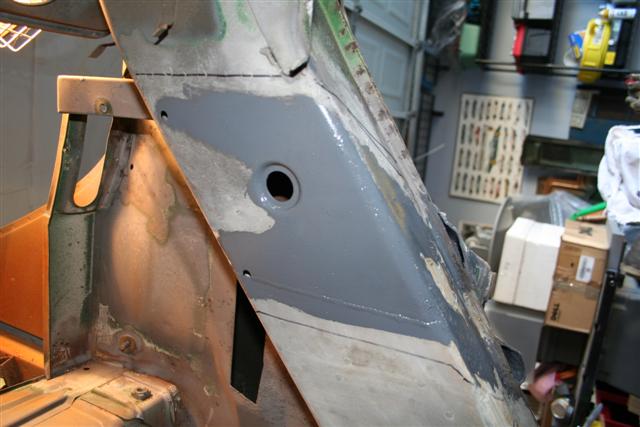

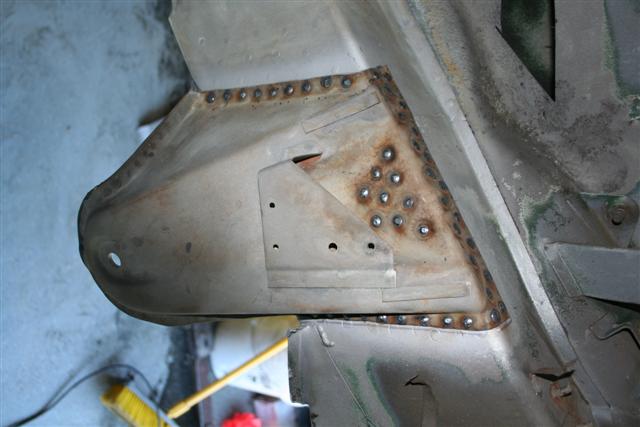

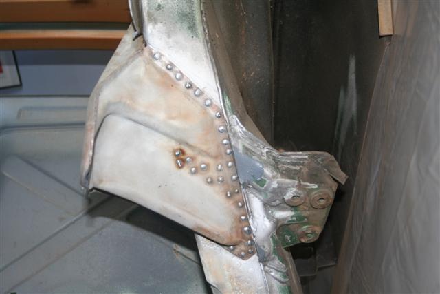

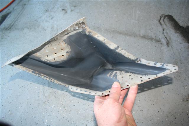

Now we move onto the inner passenger suspension console. This is a part I sourced from Restoration Design awhile back. First I drilled all of my plug weld hold, media blasted the replacement part, treated with Metal Ready, painted the interior non weldable areas with POR-15 and then finally the interior weldable areas with U-POL weldable primer.
With POR-15. Not I bent the upper flange out so I could get a good tight fit on the bottom.

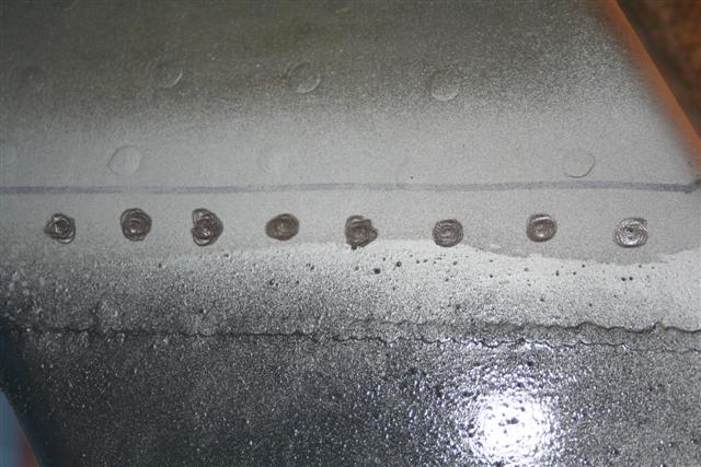

More POR-15 on non-weldable areas. This shot doesn't show the weldable primer that I am about to spray on.
Here is weldable primer, but I don't really like it that much. So I used an air die grinder with a stone and knock off the paint on the spots I will be doing my plug weld.

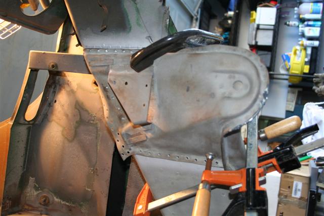

Clamped into place. At this point I measure to make sure it is in the correct location (use the good driver side as a guide), then tack weld one or two places, remeasure to make sure it hasn't moved and then do more plug welds. Again you can see the top flange bent up for the moment.
All done except for welding down the plug welds.
Shot from below. I will eventually need to rebuild the "bridge" that goes between the inner and out consoles.
