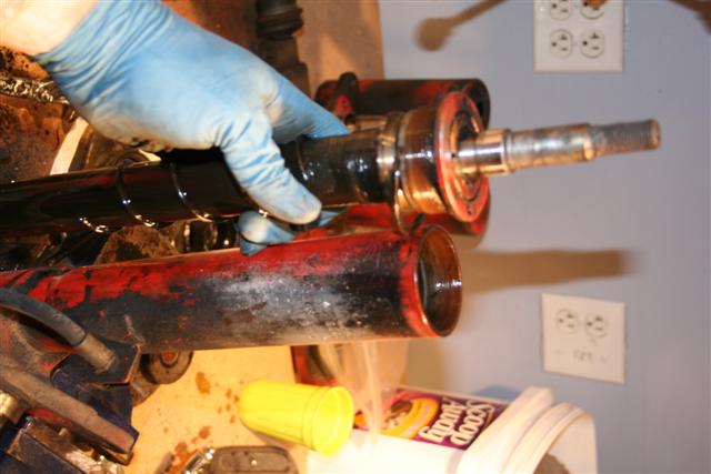

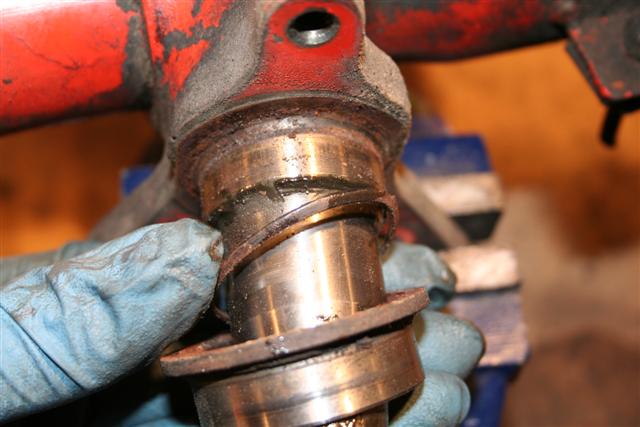

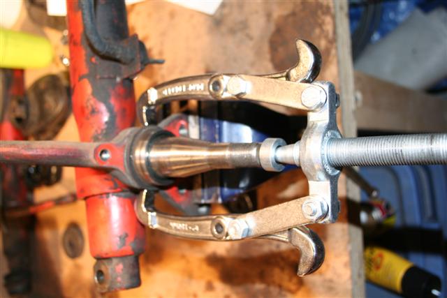

I generally do the welding stuff on the weekends when I can be noisy. If I work at night, I need something a bit quieter to work on. So I decided to refurbish the front suspension. I sourced a 911 front end that uses OEM Koni style struts. I have about 90% or so of what I need to rebuild much of the front suspension. First task is to disassemble the struts, strip and then powder coat them.
Here is the OEM Koni strut. This is not an insert in the style of the current self contained Koni inserts, but rather this is the shock internals along with the shock oil that had to be drained. I will be putting in newer Koni "yellow" sport inserts into this strut.
Here is something that I don't think many people do when redoing a strut. I am pulling off this ring that is on the spindle. Why am I doing this?...
Because there is an O-ring behind it that I want to replace. This O-ring looks to be pretty dead.
