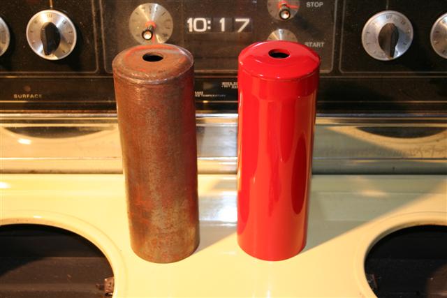

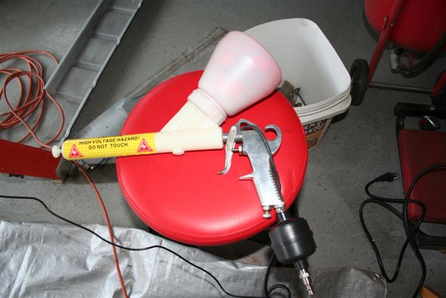

Now comes the fun that I have been looking forward to for a long time. I have had a Caswell powder coating kit and a junk yard oven for over a year, but have not had a chance to try it all out yet. So my first powder coating is with my strut dust covers as well as the special gland nuts that allow you to use a Koni insert in the OEM Koni strut
First I stripped the old paint off with Jasco. Then I washed them with soap and water and solvents to get the grease and oil off. Then I glass bead blasted them. Then I treated them with Metal Ready. I then washed them in water one last time then oven dried them.

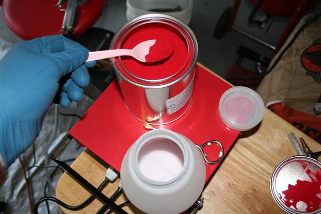

Powder goes into cup.

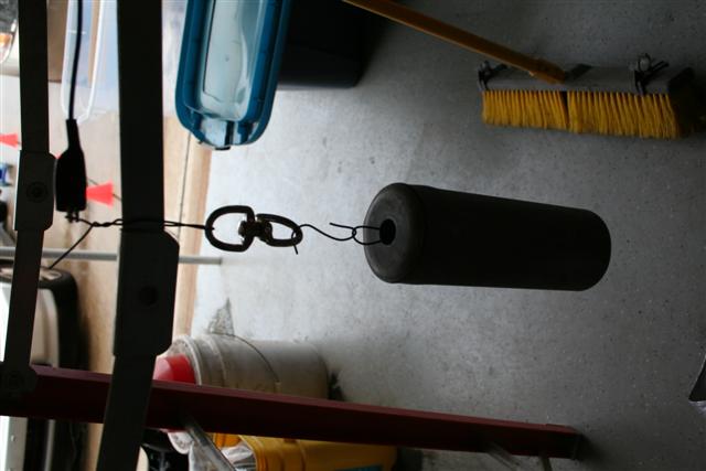

Hang part. Ground it to your corona gun. Make sure you have a swivel so you can rotate part as needed.
Gun all loaded and ready to go.

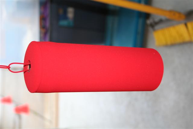

Part is now coated with powder. Sorry no action shots as I couldn't take photos and use the gun at the same time. (IMG:style_emoticons/default/biggrin.gif) Powder can just be wiped or blown off at this point. So you have to be carefull as you...

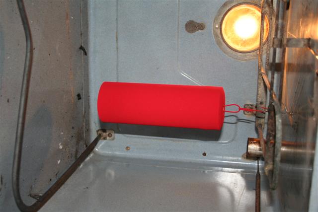

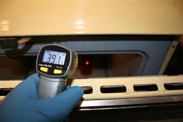

...transfer into the oven. I drilled holes in the top of the oven to install some loops that I can hang parts from. Oven was pre-heated to about 400 F prior to me putting the part in.
Powder spec says 392 F for 10 minutes. Within just a few minutes that part has warmed up to 390-400 F and the powder will melt. Crack open the oven just a bit and check temp with IR thermo. Once you are sure part is at cure temp, let it bake for 10 minutes. After 10 minutes, turn off oven, crack door a bit and allow it to cool down slowly.

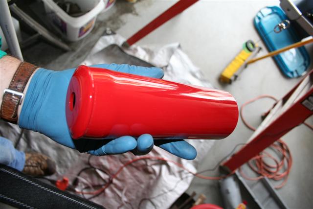

Finished product looks awsome! Especially as this is my very first part!
Other cover that has been stripped with Jasco, but prior to media blasting, etc.

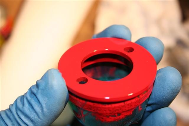

Here is one of the gland nuts. I used high temp green silicone tape to cover the threads. You can see some of the cured paint on the tape, but once you pull the tape off you can see that the threads are untouched by paint.
