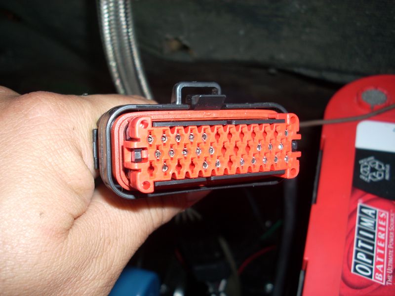

Here's the picture of the AMPSEAL connector. You can see the red seal around the perimeter.
Where does that connector go? is that the one that attaches to the MS?
I've been looking for a pair of connectors (male/female set) for quick disconnect between my engine harness and the body harness.
(Then again, I might just go with a handful of smaller connectors... hmm..)

QUOTE(RJMII @ Nov 13 2008, 01:13 PM) *
Yes, that connector goes to the MS. AFAIK, ampseal connectors were difficult to get in small qty. That may have changed. Its not an issue w/ the MS since it comes w/ both halves (plus, Im sure they are ordering them in large qty.)

QUOTE(smdubovsky @ Nov 13 2008, 11:05 AM) *
Looks like they can be had here with a min buy of 1 for $16.75 http://www.mouser.com/Search/ProductDetail...WfMWf98IA%3d%3d

QUOTE(kconway @ Nov 13 2008, 01:50 PM) *
Wow, thanks! got it ordered. =o)

smdubovsky   The microsquirt uses ampseal(?) connectors. We us...   Jul 24 2008, 12:12 PM
McMark   Here's the picture of the AMPSEAL connector. ...   Jul 24 2008, 07:53 PM
