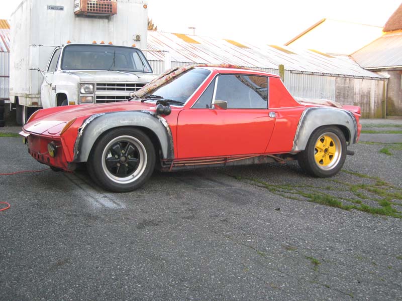

I got home Saturday just around noonish and notice this hanging out at my house:

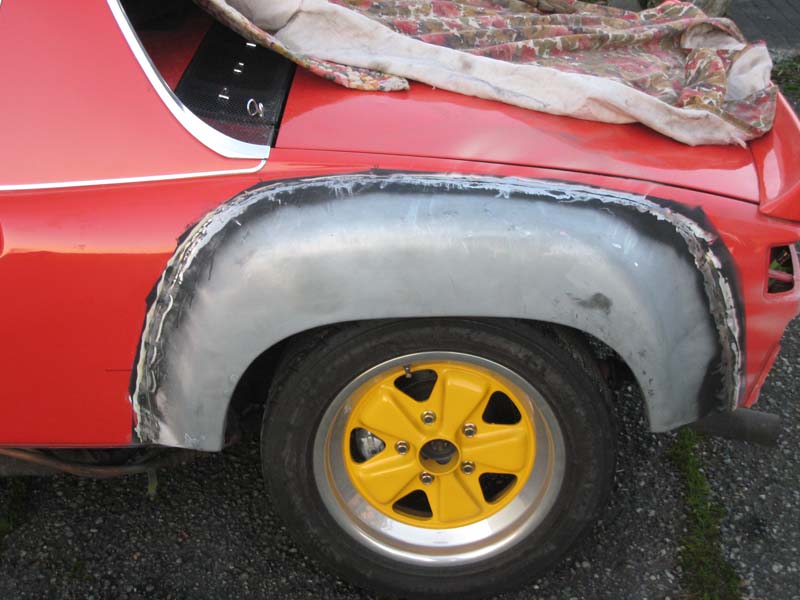

Had a chance to get out to the shop today
ground down the welds, looked great, except the rr fender
this quarter was hit by a bunch of drunk kids long ago
and had lots of work into it from the previous repair
so there is one high spot an a few low spots
but the other quarters look fairly darn clean

Root_Werks   Next thing I know, Steve Peters is pulling flares ...   Nov 9 2008, 07:09 PM
Root_Werks   By one-o-clock, we had already made our first fitt...   Nov 9 2008, 07:10 PM

pete-stevers   Had a chance to get out to the shop today ground d...   Nov 13 2008, 07:50 PM
