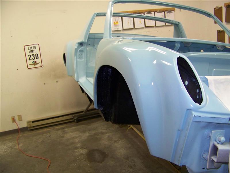

Put a few hours into metal work....well may more than a few,
spray with filler, sand, paint, sand, buff and look what you get.

PanelBilly   Put a few hours into metal work....well may more ...   Nov 14 2008, 02:13 PM

PanelBilly   The top of the flare is below the top of the fende...   Nov 14 2008, 04:34 PM
Root_Werks   Yup, the biggest thing is getting the bottom edges...   Nov 14 2008, 05:08 PM

pete-stevers   here is a shot of the car with a bit of filler on ...   Dec 13 2008, 10:24 PM
pete-stevers   once i got most of the shaping done, with many gui...   Dec 13 2008, 10:31 PM

pete-stevers   for all the taping and prep i could have almost pa...   Dec 14 2008, 11:49 AM
Root_Werks   Great job Steve! Man, from here, it looks lik...   Dec 14 2008, 02:11 PM

PanelBilly   How did the underside turn out? Are you planning o...   Dec 14 2008, 04:37 PM
pete-stevers   i sprayed the welds with etch coat, and k201, next...   Dec 14 2008, 04:52 PM

pete-stevers   pardon me..the primer was a PPG k38 the primer was...   Dec 15 2008, 06:43 PM
messix   trust the touch of your hand and the guide coat mo...   Dec 15 2008, 08:27 PM

pete-stevers   my opinions on the sanding so far...it is tough to...   Dec 16 2008, 12:51 PM

pete-stevers   i am planning to do the final block with 800 wet I...   Jan 14 2009, 05:19 PM

pete-stevers   i have finished blocking the second layer of prime...   Jan 26 2009, 08:51 PM

pete-stevers   Well i got a little farther today sprayed a layer ...   Jan 30 2009, 08:09 PM
pete-stevers   this is the quarater that caused the most trouble ...   Jan 30 2009, 08:11 PM
pete-stevers   and here is my big bad...can't even look at sc...   Jan 30 2009, 08:14 PM
pete-stevers   All of this would not be possible without Sher tal...   Jan 30 2009, 08:16 PM

pete-stevers   toughest part so far is the filling,puttying and b...   Jan 30 2009, 08:25 PM
