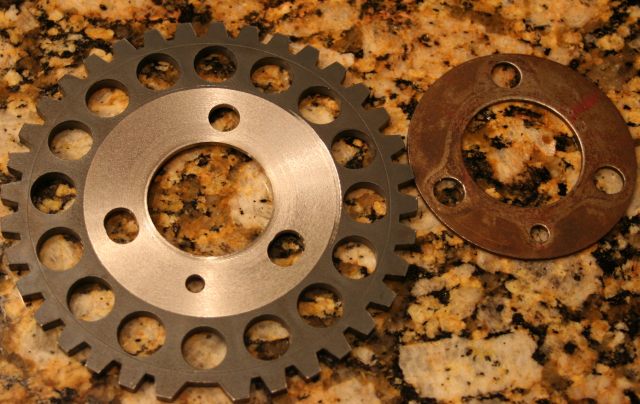

I got a picture of the trigger wheel from the machine shop. A bit of a goof on two of the holes, but that's fixed on the future ones. This trigger wheel will drop on in place of the fan spacer. Once I get this in hand, I'll need to devise a sensor mount. Ideally, it'll be something that could be installed without removing the fan housing. But we'll see about that.
