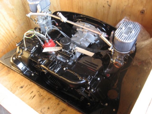

Contrast with my recent turn key 2270 Performer version that cost a nominal $10 grand, plus miscellaneous extras, crating, shipping, etc.
