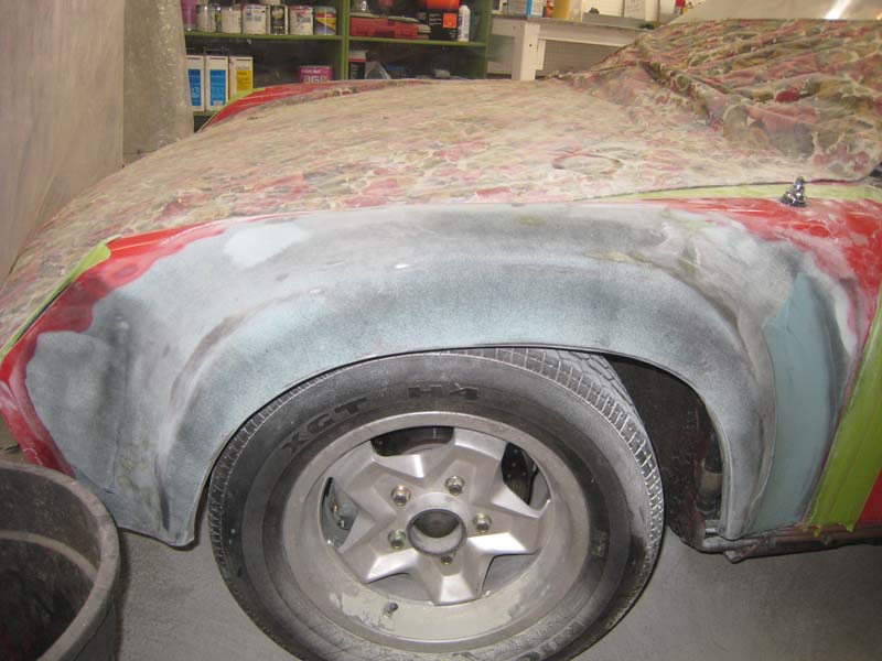

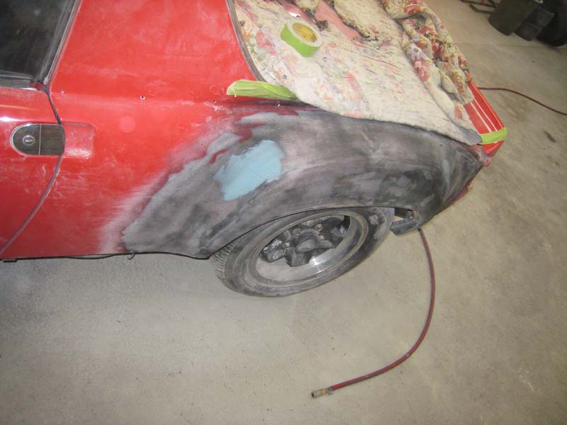

here is a shot of the car with a bit of filler on it...
I should let you know, this is the first time i have EVER attempted body work of this magnitude....
the rear driver quarter has taken the most work this far!

pete-stevers   here is a shot of the car with a bit of filler on ...   Dec 13 2008, 10:24 PM
pete-stevers   once i got most of the shaping done, with many gui...   Dec 13 2008, 10:31 PM
effutuo101   Nice work! keep it up.   Dec 14 2008, 11:36 AM
pete-stevers   for all the taping and prep i could have almost pa...   Dec 14 2008, 11:49 AM

PanelBilly   How did the underside turn out? Are you planning o...   Dec 14 2008, 04:37 PM
pete-stevers   i sprayed the welds with etch coat, and k201, next...   Dec 14 2008, 04:52 PM

pete-stevers   pardon me..the primer was a PPG k38 the primer was...   Dec 15 2008, 06:43 PM
messix   trust the touch of your hand and the guide coat mo...   Dec 15 2008, 08:27 PM
Wes V   trust the touch of your hand and the guide coat m...   Dec 16 2008, 09:27 AM
elwood-914   Great thread!! You guys make it look too e...   Dec 16 2008, 11:14 AM
pete-stevers   my opinions on the sanding so far...it is tough to...   Dec 16 2008, 12:51 PM
