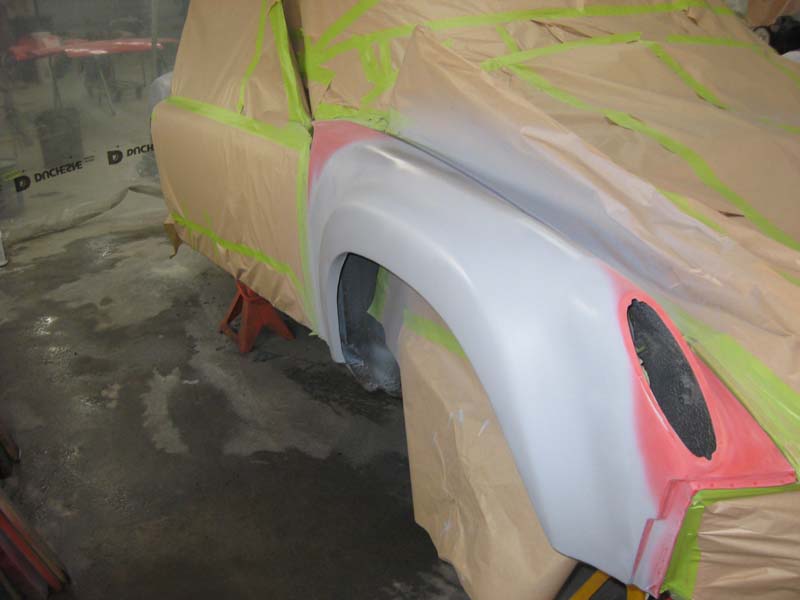

once i got most of the shaping done, with many guide coats and much blocking, i decided to prime with a heavy ppg k201.
After letting it cure i will block and clean up any other imperfections.....and there are more than just a few (IMG:style_emoticons/default/headbang.gif)

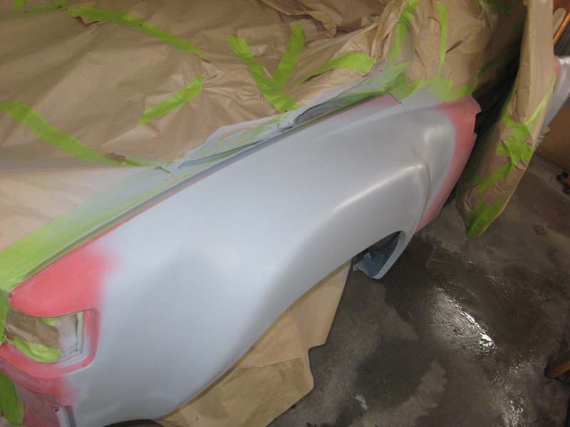

pete-stevers   here is a shot of the car with a bit of filler on ...   Dec 13 2008, 10:24 PM
pete-stevers   once i got most of the shaping done, with many gui...   Dec 13 2008, 10:31 PM

pete-stevers   for all the taping and prep i could have almost pa...   Dec 14 2008, 11:49 AM

PanelBilly   How did the underside turn out? Are you planning o...   Dec 14 2008, 04:37 PM
pete-stevers   i sprayed the welds with etch coat, and k201, next...   Dec 14 2008, 04:52 PM

pete-stevers   pardon me..the primer was a PPG k38 the primer was...   Dec 15 2008, 06:43 PM
messix   trust the touch of your hand and the guide coat mo...   Dec 15 2008, 08:27 PM

pete-stevers   my opinions on the sanding so far...it is tough to...   Dec 16 2008, 12:51 PM

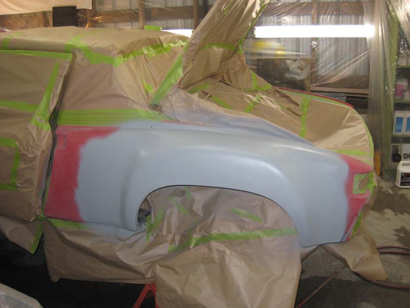

pete-stevers   i have finished blocking the second layer of prime...   Jan 26 2009, 08:51 PM

pete-stevers   Well i got a little farther today sprayed a layer ...   Jan 30 2009, 08:09 PM
pete-stevers   this is the quarater that caused the most trouble ...   Jan 30 2009, 08:11 PM
pete-stevers   and here is my big bad...can't even look at sc...   Jan 30 2009, 08:14 PM

pete-stevers   toughest part so far is the filling,puttying and b...   Jan 30 2009, 08:25 PM
