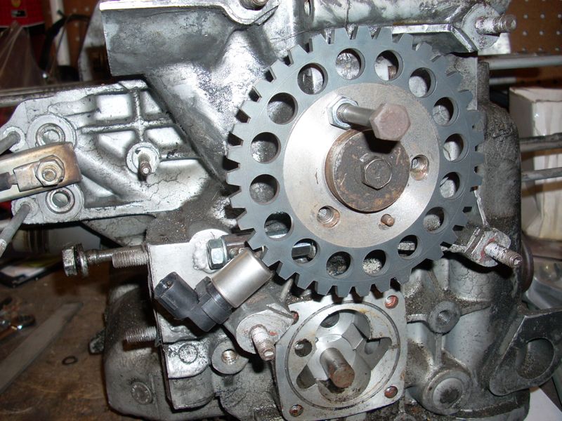

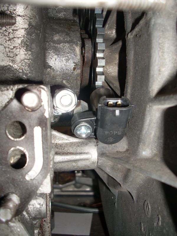

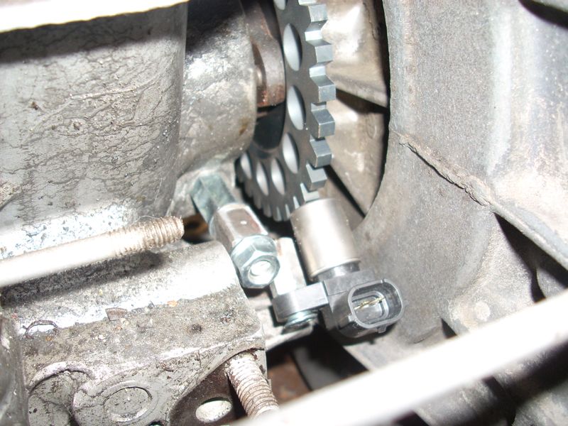

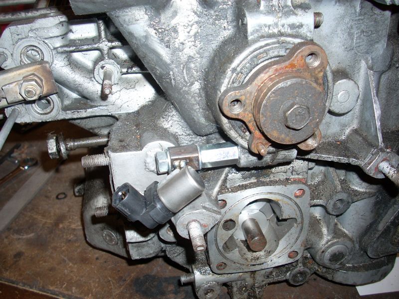

FINALLY made some more progress on this install. I got the toothed wheel back from Mike Mueller, who did the mods for me. It fits just fine and I installed it on my latest 2056 during the cam break in. So it spins just fine, as expected.
I did a lot of searching in the back room of my local NAPA, opening every VR sensor box they had to find one that was small and light. This is the one that I found and I assembled a quick test bracket. The VR sensor will mount on the existing case stud so there will be no holes or other modifications made to any parts.
Installing this system will require the motor to be removed and the fan housing to be unbolted. Even though removing the motor isn't ideal for a 'bolt-on' system, I think that eliminating the need for permanent modifications is a worthwhile goal.
Anyway, here's the pics. I have a couple videos as well that I'll post shortly. (IMG:style_emoticons/default/cool.gif)

This looks like you are moving the fan out by the thickness of the gear wheel. How is this going to work?
My guess is that the toothed wheel is replacing the steel spacer that goes behind the fan... Thus preserving the required spacing...

McMark   Yup, the timing gear is the exactly the same thick...   Jan 6 2009, 07:21 PM
