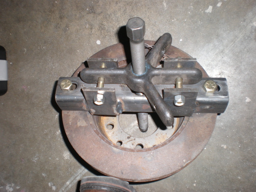

Those are some neat tools! I really like the arm shaft puller. I've been using heat and yes it does make a stinky mess!
I came up with this cobbled together piece for pressing out stub axles while the arm is still in the car. Had to beat one out at the track last year and it made me want to throwup. Fortunately all of the beating didn't hurt anything or change my toe, but I decided that was the last time a hammer would be involved in that operation!
It works great! An old brake disc, a few minutes on the mill (could have been done without the mill) and a few welds. The giant three jaw puller was given to me years ago so the whole apparatus was damn near free.
I lke this thread. Hope more homemade tools follow.
