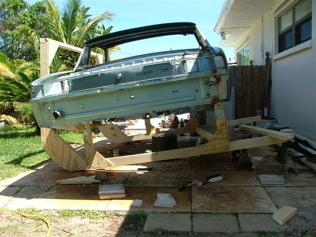

This thread would not be complete without FourBlade's RockingChair Rotisserie
(IMG:style_emoticons/default/dancinnanner.gif)
T.C.
