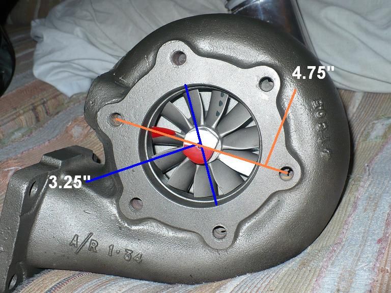

Dr Evil   Small hijack, but may help this thread as well as ...   Jan 10 2009, 02:35 PM
RJMII   how about a link? http://www.ztechz.net/id4.html...   Jan 10 2009, 02:44 PM

RJMII   On the first link to an ebay turbo, what is the ...   Jan 10 2009, 11:14 PM
turnaround89   Thanks for the answers RJMII, i had to read throug...   Jan 10 2009, 11:31 PM
