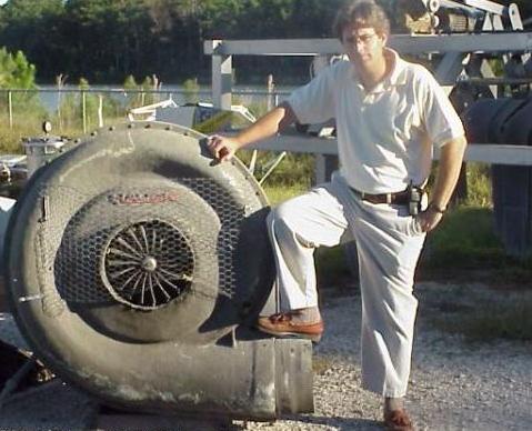

I think this would be a perfect match for your drivetrain, it has a little lag but when it kicks in it should give you the extra power you are looking for. (IMG:style_emoticons/default/biggrin.gif)
sww914
post Jan 10 2009, 11:57 AM
Posts: 2,439
Joined: 4-June 06
Member No.: 6,146
QUOTE(plymouth37 @ Jan 10 2009, 08:15 AM) *
That one should kick in at about 90,000 RPM's and be good up to about 200,000 RPM's. (IMG:style_emoticons/default/smile.gif)
