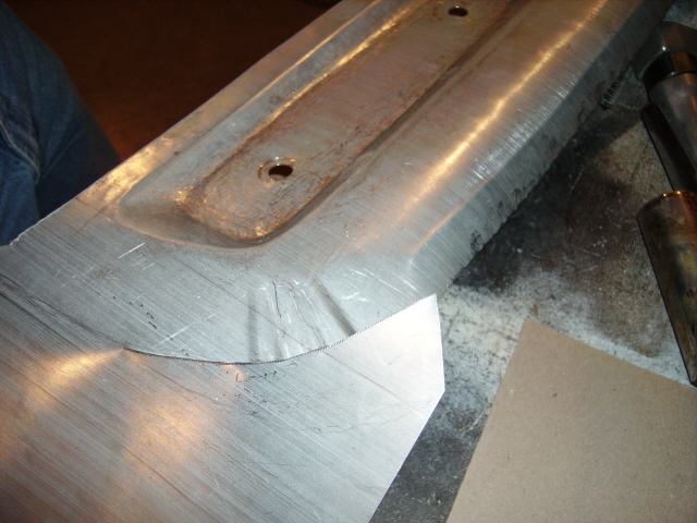

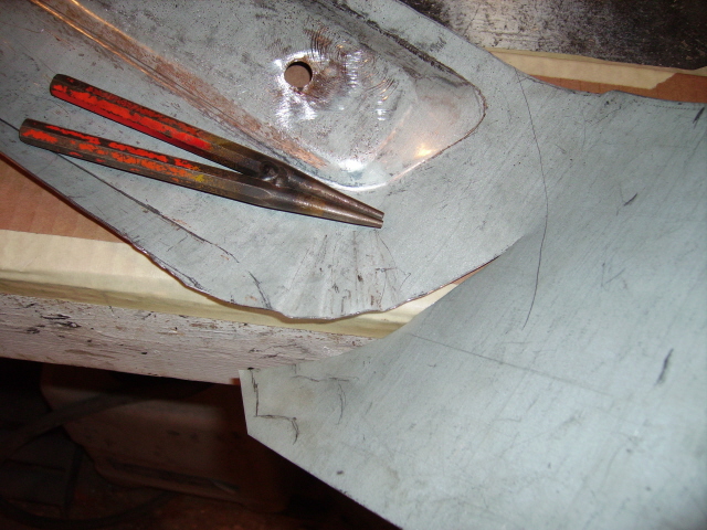

I made these for doing large deep shrinks. You slip them over the panel and give them a twist. This gathers the metal. Then... (IMG:style_emoticons/default/smash.gif) carefully shape the curve. I'm sure you can buy them someplace.

rick 918-S   I made these for doing large deep shrinks. You sli...   Jan 10 2009, 01:57 PM
rick 918-S   Here is the result or close to it.   Jan 10 2009, 01:57 PM
