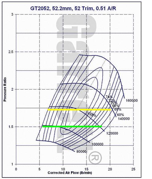

I think a Garrett GT2052 is a pretty good match for your application. These are nice because they have such a high compressor efficiency for their frame size, 77%.
Here's the map. The yellow line is 10psi from 1800rpm to 6000rpm. The green line is 8psi from 1800 to 6000rpm. Both are estimated at 90% volumetric efficiency.
