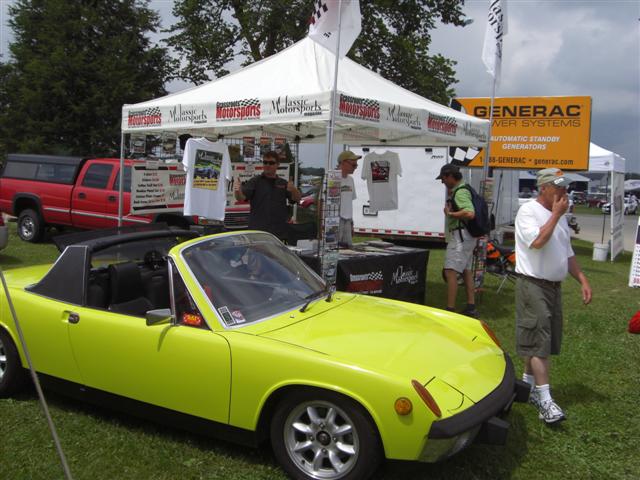

Ah, Good Doctor. Not that you need more reading for your non-existent spare time, but both books were very helpful in the 914T project. The remote mount has its issues, but its benefits as well. I really liked the way everything seemed to fall into place with out looking smashed into its location. Oil and plugs are still (almost) easily accessible. The fun part can be seen in the photo below- I was at Road America this past summer, and happened into Joe Gearin, who checked out the car and liked it, so much so that he invited me to put it by the tent for a day. Standing across the street, with an ice cream treat, watching folks check out the car, seeing the boost gauge in the tach, the intercooler under the hood, and scratch their heads wondering where the turbo was... priceless.
