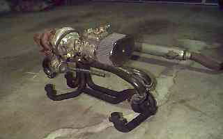

Some pics I poached (IMG:style_emoticons/default/smile.gif)

Dr Evil   I am considering using my corvair turbo and side d...   Jan 10 2009, 12:15 AM

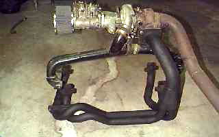

Dr Evil   Some pics I poached :)   Jan 12 2009, 05:47 PM
