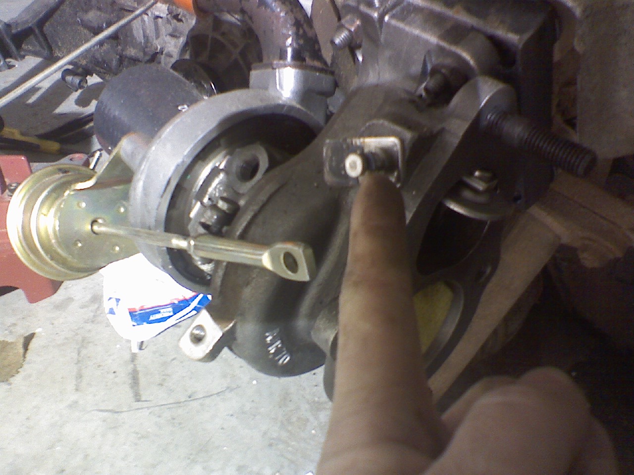

What that gold thing does. =o)
I went and took my turbo apart to take some pics for you. This should help some with basic questions understand a little bit more.
