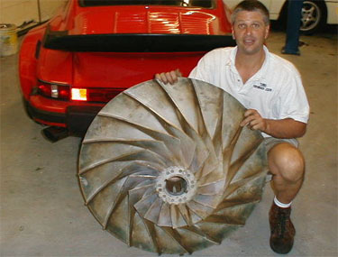

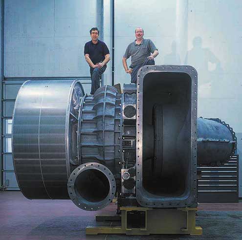

Go big:
This Porsche owner has the right idea about impeller size:

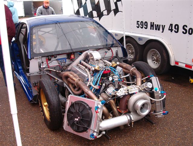

This is a nice set up (but a little small) that might fit a 914:
