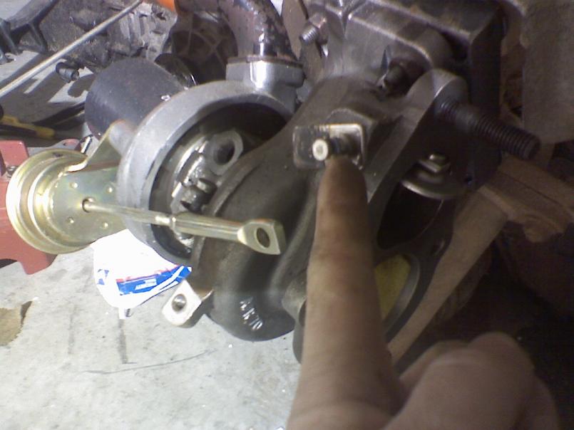

What that gold thing does. =o)
I went and took my turbo apart to take some pics for you. This should help some with basic questions understand a little bit more.

QUOTE(RJMII @ Jan 12 2009, 09:20 PM) *
That is for the waste gate a C Clip should hold that on there.. Some hot rodder's weld it so it doesnt open for max boost.. When the Booost reaches its pressure the wastegate opens waisting boost back into the exhaust system..

QUOTE(ONTHEGRIND @ Jan 13 2009, 04:47 PM) *
LOL yeah, we know. I pulled the c clip off to take the picture so I could answer his question. read the previous two pages where I fill in the details that go with the picture. (IMG:style_emoticons/default/av-943.gif) (IMG:style_emoticons/default/av-943.gif) (IMG:style_emoticons/default/av-943.gif)
here: let me make it easier for you:
QUOTE(RJMII @ Jan 10 2009, 10:14 PM) *
QUOTE(turnaround89 @ Jan 10 2009, 06:51 PM) *
On the first link to an ebay turbo, what is the giant gold piece hanging off the turbo, i see those on a lot of turbo's but haven't been able to identify what it actually is? What is it?
There is a little diaphraghm in there that pushes on the rod. There is a vacuum/boost line that goes to the manifold that builds pressure inside of the one side of the diaphragm. the other side has the rod on it, which, in turn, opens the wastegate to release exhaust gasses that would otherwise be spinning the impellers.
