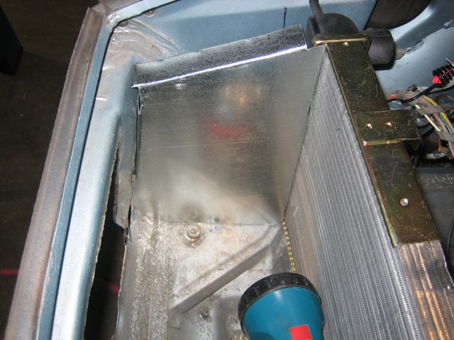

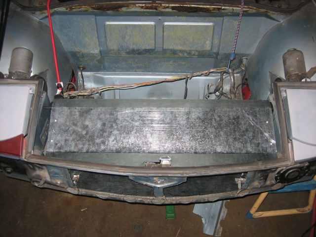

-I tackled the radiator shroud and finished it. This was the biggest ???? for me and I am glad that I was able to do it. It was my first time working with sheet metal, so it isn't pretty but I think it will do the job.

First...test fitting and making panels
