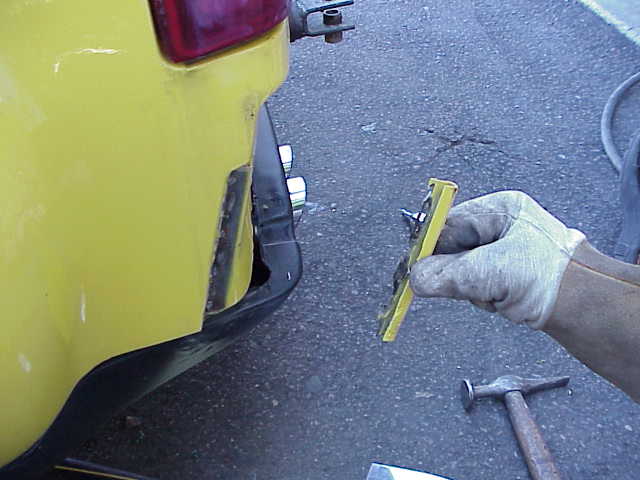

boxstr   Pic 1   Jan 21 2004, 07:30 PM

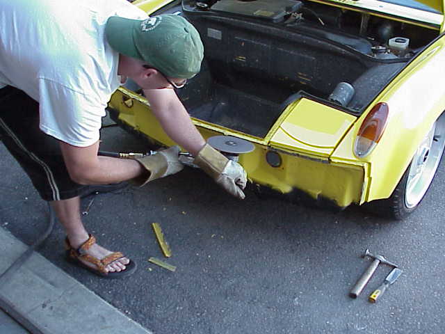

boxstr   Pic 2   Jan 21 2004, 07:31 PM

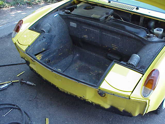

boxstr   Pic 3   Jan 21 2004, 07:32 PM

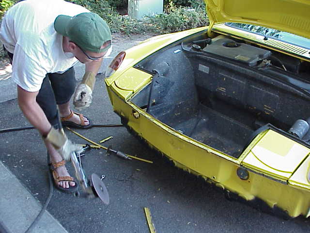

boxstr   Pic 4   Jan 21 2004, 07:32 PM

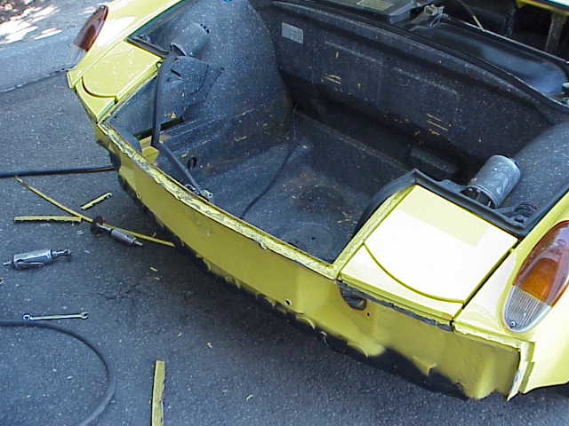

boxstr   Pic 5   Jan 21 2004, 07:33 PM

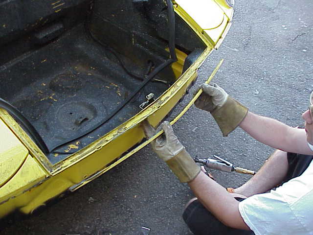

boxstr   Pic 6   Jan 21 2004, 07:35 PM

boxstr   Sorry a couple of pics were out of sequence. One t...   Jan 21 2004, 07:55 PM
Bleyseng   Yep, its pretty easy to do as Craig showed. Fabing...   Jan 21 2004, 08:07 PM
