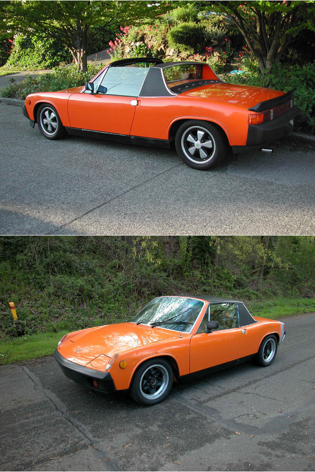

I am starting the process of going Old School with my bumpers. I have a 76 and I am buying a older rear from Kevin this weekend. I have read the posts about this process (not much info) so I am asking if anyone has done this could they give me some tips. I don’t know how much work is involved retrofitting the older bumpers. Any help would be appreciated.

Yep, its pretty easy to do as Craig showed. Fabing the rear rubber support piece takes abit of doing but its not hard.
I have $250 into the used early chrome bumpers,fogs,good rubber tops. Still need to finish the painting as I found some rust under the late bumper covers.
