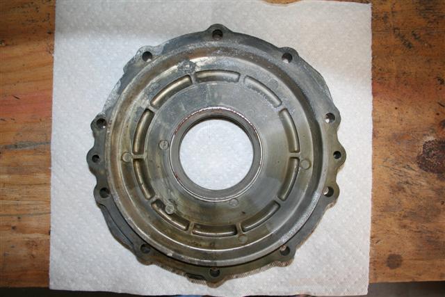

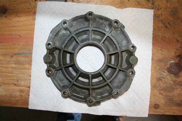

Here are the photos of the diff cover. It sat in my garage for about two months and then outside hanging under my back porch for about six months. Roughly in these photos the top 1/2 are untreated. The bottom half are Gibbs, CRC Heavy Duty Corrosion Inhibitor (waxy "Tectyl" like coating) or a mix of the two. Around 3 and 9 o'clock are Gibbs + CRC. Just below that is Gibbs alone and at the very bottom is CRC alone.
Observations...
  1. CRC Heavy Duty Corrosion Inhibitor is working really well.
  2. Gibbs Brand Penetrating Oil/Lubricant does provide some protection. But not as good as the CRC product.
  3. Gibbs + CRC together seem to work fine, but I can't tell any difference than just using the CRC product by itself.
  4. Areas that were cleaned via media blasting corroded the most.
  5. The chromate conversion (even if mostly gone) is still providing some protection.
  6. Areas that might get abraded via handling, weather, etc. have the most corrosion. Specially the Gibbs protected area show corrosion in raised areas that are most likely are due to the Gibbs being either soaked up or abraded/weathered away. You can see this clearly on the inside on the right hand side (that was media blasted) at approximately 4-5 o'clock position. On the raised ring, you can see magnesium corrosion in the Gibbs area.
My conclusion so far are...
  1. Media blasting is the best at cleaning, but it removes the chromate conversion that may still provide some corrosion protection.
  2. Gibbs Brand Penetrating Oil/Lubricant works, but it's not a miracle product.
  3. CRC Heavy Duty Corrosion Inhibitor seems to work the best. This is not surprising since Porsche also used a waxy protectant (Tectyl) on the magnesium transmissions parts.
outside
inside
