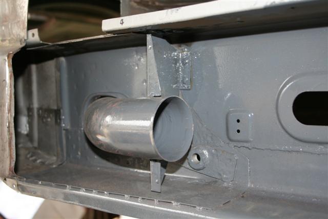

Brackets and the metal heater tubes all welded into place. Everything has been painted in POR-15. It all went together pretty well. I have test fitted the actual heater tube and it fits fine. I have the three "U clips" that hold the tube in place ready to go. Those are riveted into place. However before I put them on, I want to finish some welding on the interior side of the longitudinals. Those welds will burn through some of the POR-15 and I want to touch that up before I close this section up.

Richard Casto   Brackets and the metal heater tubes all welded int...   Jan 21 2009, 10:49 AM
