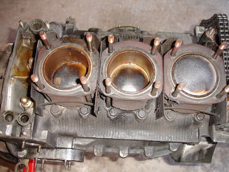

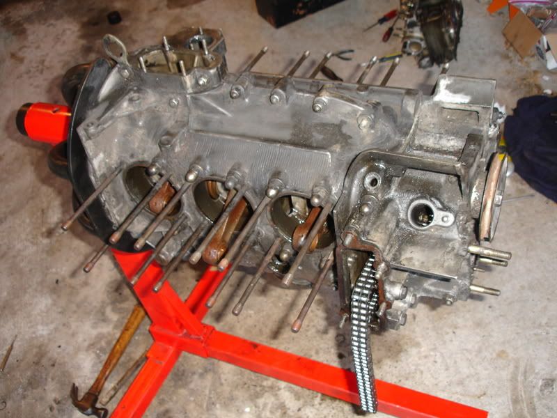

Right side of the shortblock:
(IMG:http://img.photobucket.com/albums/v124/big_pete139/1970%20Porsche%20914%206/PC456.jpg)
(IMG:http://img.photobucket.com/albums/v124/big_pete139/1970%20Porsche%20914%206/DSC00471.jpg)

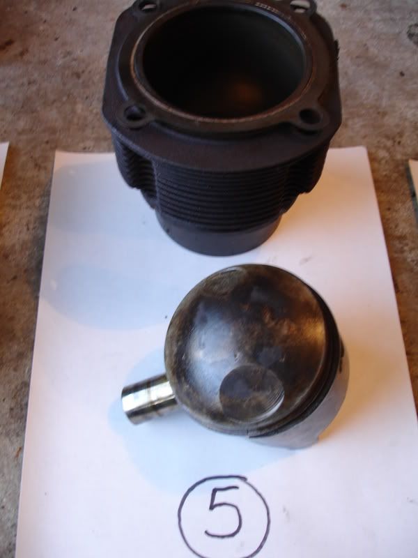

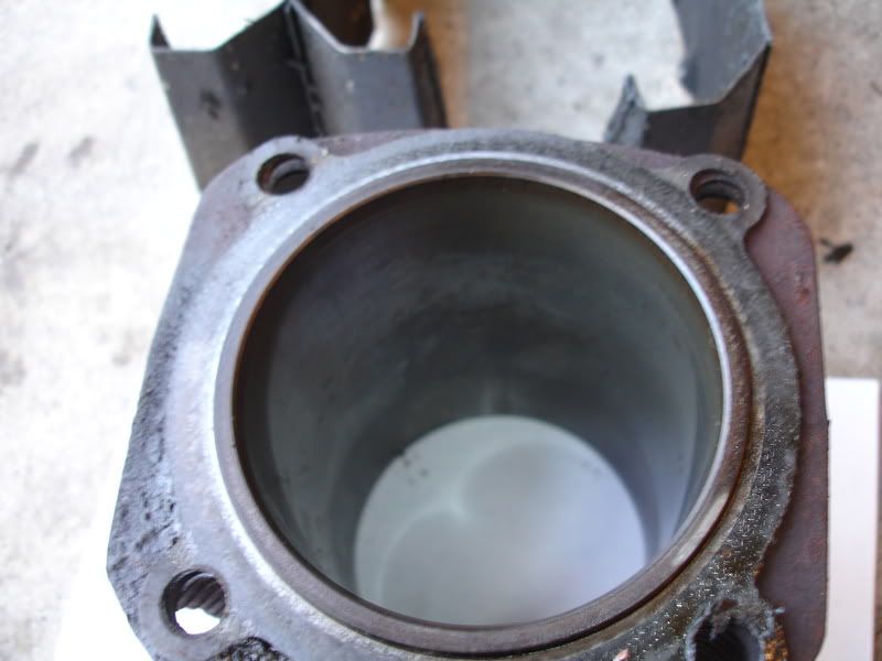

This is pretty much the condition of all:
(IMG:http://img.photobucket.com/albums/v124/big_pete139/1970%20Porsche%20914%206/PC5.jpg)
(IMG:http://img.photobucket.com/albums/v124/big_pete139/1970%20Porsche%20914%206/CylinderWall1_A.jpg)

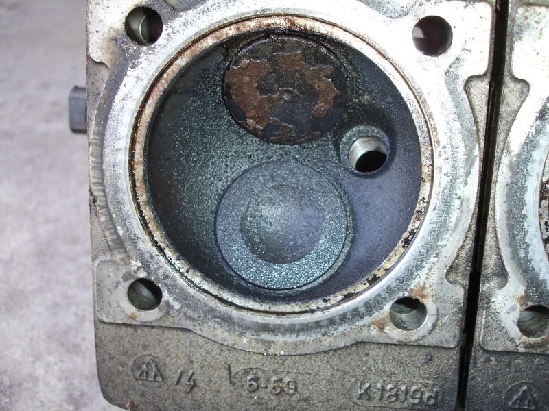

Here is each P&C set with it's corresponding head / ports.
1
(IMG:http://img.photobucket.com/albums/v124/big_pete139/1970%20Porsche%20914%206/Set1.jpg)
(IMG:http://img.photobucket.com/albums/v124/big_pete139/1970%20Porsche%20914%206/Valves1.jpg)
2
(IMG:http://img.photobucket.com/albums/v124/big_pete139/1970%20Porsche%20914%206/Set2.jpg)
(IMG:http://img.photobucket.com/albums/v124/big_pete139/1970%20Porsche%20914%206/Valves2.jpg)

But, this is where the kicker is. I have been EXCEEDINGLY careful and gentle throughout this entire disassembly process with the magnesium parts. I am unsnapping the circlips that hold the wristpins to the pistons and this "piece" falls out onto the garage floor. In the back of my mind, I think, "Oh sh*t!" but tell myself not to worry. I examine the piece, and instantly realize it's a broken piece of the #2 cylinder!
(IMG:http://img.photobucket.com/albums/v124/big_pete139/1970%20Porsche%20914%206/BrokenPiston2.jpg)
So, I'm now in panic mode.
Guys & gals, what are my options?
  • Where could I find another, single, stock 2.0T piston? 80 mm bore, 66 mm stroke?
  • Is JE Pistons a reasonable option (that is in my price range <$1K) ?
  • Stock is 8.6:1, but what piston set will yield a slightly higher compression?
  • I understand that 2.2L pistons share the same crank, and the 2.0 heads need to be matched. How do they do this?
I do NOT want to switch to 2.2L heads though. I am aiming for near stock, and a stock cam.
