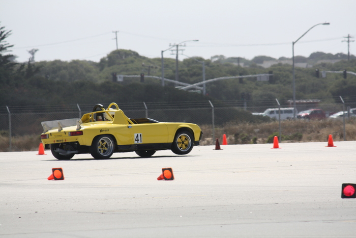

BTW, if ya'll want a rematch, it'll be at Packwood WA, August 8 & 9.
Ya'll come to our house & lay a whippin' on us'n & we'll call it even. (IMG:style_emoticons/default/biggrin.gif)
I think Andrew remembers this car.
