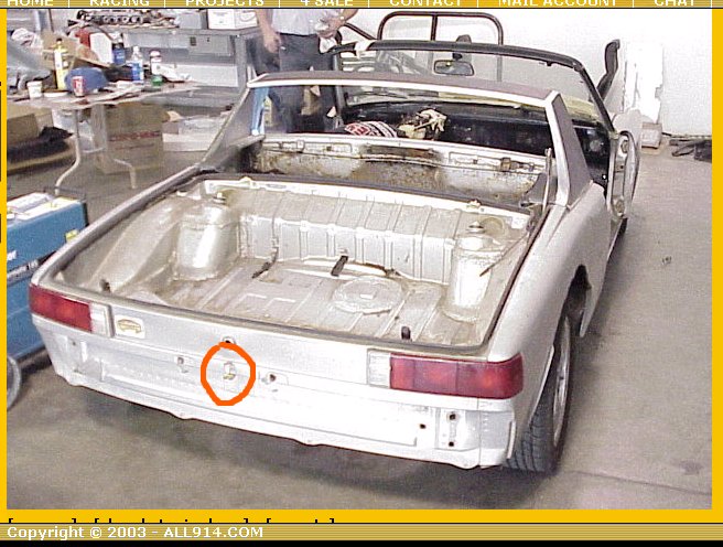

Thanks for posting the photos. I don't have access to any whole early cars. I found this picture on all914.com. I've circled the bracket.

kafermeister   Yes. We do. We also need to find a way to hold u...   Jan 21 2004, 01:56 PM
