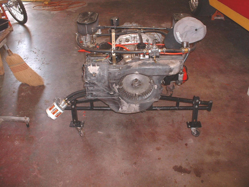

Here is Paul Woodbury's (URY914) engine bar...love the wheels.... (IMG:style_emoticons/default/biggrin.gif)

QUOTE(Jeff Bowlsby @ Jan 26 2009, 12:38 PM) *
I like that. (IMG:style_emoticons/default/beerchug.gif) Are there more pictures around?
