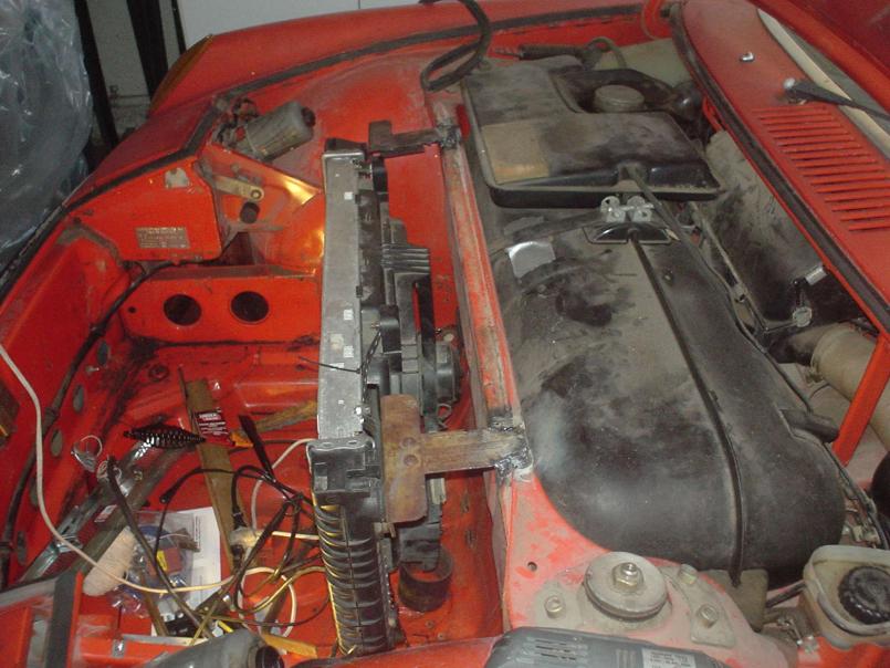

Nice job! Im in the process of putting the JDM EJ20 into my 1970 914, I used an old BMW radiator my father had laying around down i San Diego, and still need to clean up how the mounts look. How much did you spend on the kennedy adapter plate? Attached Image
The KEP adapter plate/flywheel/pilot bearing and all necessary parts is about 500 shipped. I got a few other things that bumped up my cost.
www.kennedyeng.com
Looks good...I do have one concern with your radiator setup though (and others may agree) the radiator may be to close to the gas tank wall and have problems with getting the hot air out of the engine compartment assuming you are venting through the fenders.
going through the hood might be an ideal situation for your setup
not too sure... anyone else??
I'd be concerned with both the lack of ducting and lack of exhaust area. Air will always try to go the path of least resistance which means that without good ducting it will flow right out your exhaust holes. As a rule of thumb you want much more exhaust area than intake area and I don't see how you can attain that with that radiator placement. In any case, those are just my opinions.

charliew   007 all that setup will do is recirculate the hot ...   Jan 28 2009, 02:07 PM
