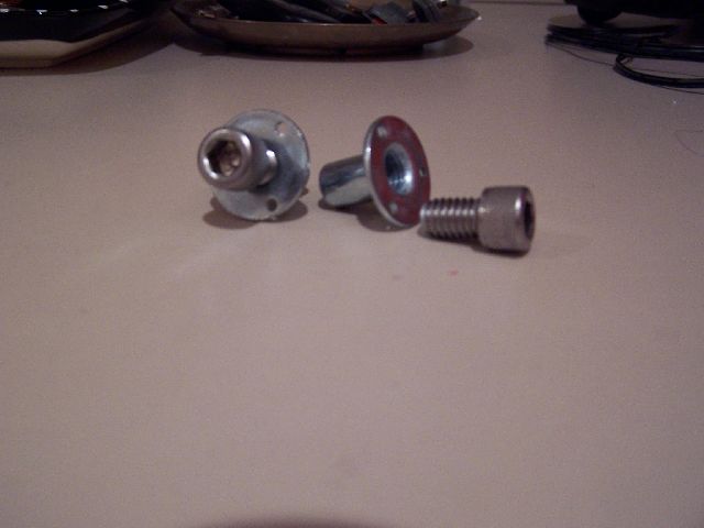

Here is a pic of the "tee nuts" that I use for the foglights, along with a new allen allen bolt. You will also wnat to add a flat washer and a lock washer. All items are stainless steel.
CCLINNUTZANDBOLTZ

Bleyseng   For the early fogs I used a blind nut which is the...   Jan 22 2004, 09:46 AM

Gint
  Jan 22 2004, 07:46 PM
Bleyseng   Ok, I'll dig them out of the assortment box (p...   Jan 22 2004, 09:35 PM
maf914     Jan 23 2004, 08:03 AM
Bleyseng   heres the pieces put together   Jan 23 2004, 08:29 PM
Bleyseng   here is the 3 pieces   Jan 23 2004, 08:30 PM
Gint   Thanks Geoff. I've never seen those before.   Jan 23 2004, 10:34 PM
Neal   Geoff, were do we buy them ? Neal   Jan 24 2004, 12:28 AM
Bleyseng   I found them at Hardwicks in Seattle but I am sure...   Jan 24 2004, 12:29 AM
