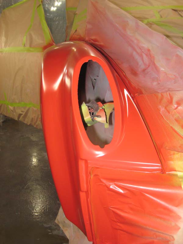

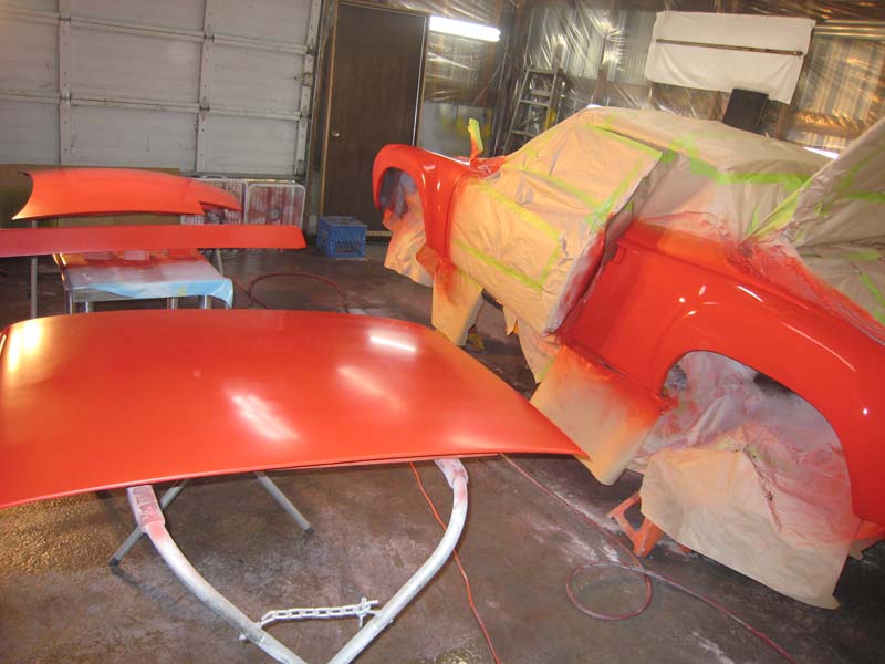

Well i got a little farther today
sprayed a layer of undercoat in the innner fenders
and got a three layers of base on
