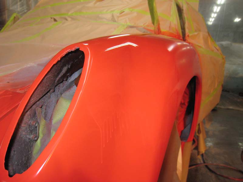

pete-stevers   Well i got a little farther today sprayed a layer ...   Jan 30 2009, 08:09 PM
pete-stevers   this is the quarater that caused the most trouble ...   Jan 30 2009, 08:11 PM
pete-stevers   and here is my big bad...can't even look at sc...   Jan 30 2009, 08:14 PM
pete-stevers   All of this would not be possible without Sher tal...   Jan 30 2009, 08:16 PM
greenie   Great job Pete, I can't wait to see it! D...   Jan 30 2009, 08:22 PM
pete-stevers   toughest part so far is the filling,puttying and b...   Jan 30 2009, 08:25 PM
greenie   toughest part so far is the filling,puttying and ...   Jan 30 2009, 08:44 PM
