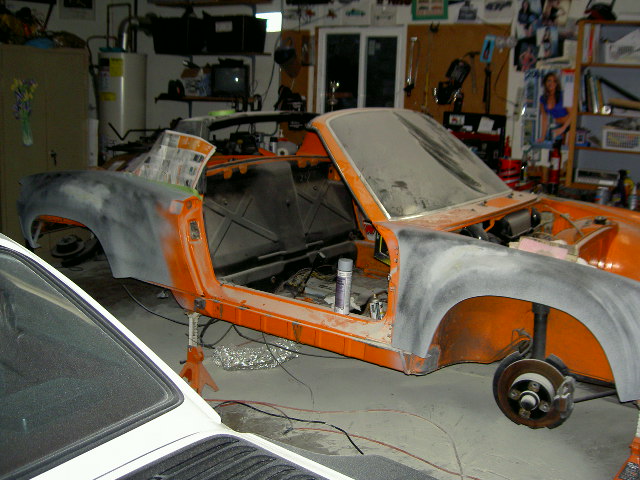

I got home Saturday just around noonish and notice this hanging out at my house:

toughest part so far is the filling,puttying and blocking of the quarters
i enjoy the painting part....except for the runs... (IMG:style_emoticons/default/mad.gif)
but i enjoy the solitude working in the shop!

QUOTE(pete-stevers @ Jan 30 2009, 06:25 PM) *
The shaping/blocking is very tough for me, I think I'm finished and the next night I'm starting over ( maybe it's the (IMG:style_emoticons/default/beer3.gif) ).
The solitude is the best part, (although it is very dusty solitude) many hours to think.
Keep at it.
