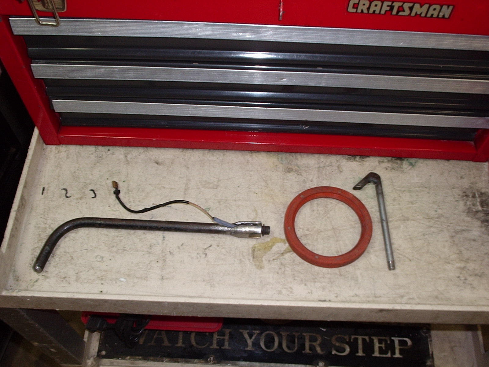

majkos
post Feb 1 2009, 10:20 AM
Posts: 1,370
Joined: 29-February 04
From: Mile High 914
Member No.: 1,729
Simple 13mm socket, 914 jack handle, cut at a certain length,
(to fit in engine compartment.)
Welding, grinding, cut off tool makes slot for wire.
No need to remove intakes. (IMG:style_emoticons/default/aktion035.gif)
The other tool is a "Short" Engine seal removal.
Can't remember why I was in tight quarters,
but 5 minutes,Fabing and welding, seal removed and moved on.
Think I was getting ready for some AX'ing, the next day (IMG:style_emoticons/default/blink.gif)
