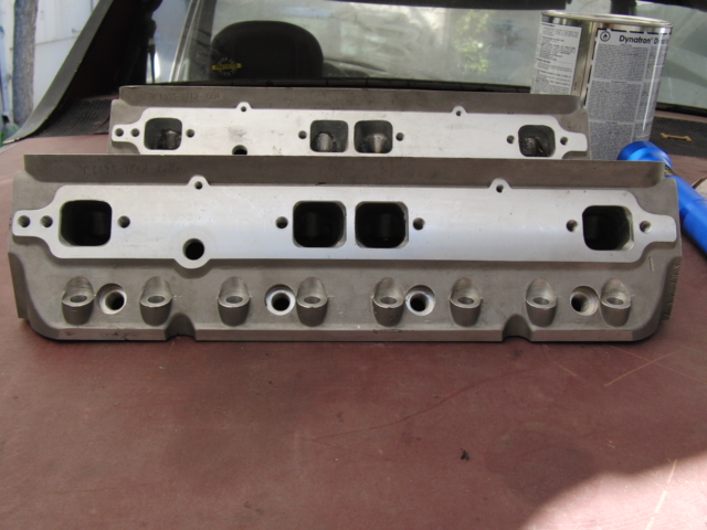

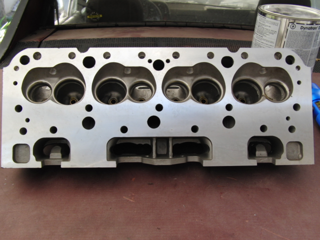

I picked up a bare set of aluminum heads today, only have valve guides and seats installed. One of them is ported to the max, the other virgin. They have holes for regular valve covers and center bolt valve covers. They have seats for 2.02" and 1.60" valves. The burn chamber is heart shaped. There are no brands stamped anywhere. On the outside right under the valve cover lip they each have a sequence engraved: PC 3003-0712-0851 and PC 3003-0714-0858. Also on the raw part next to the machined intake ports side, one has the numbers 712 18S, the other 712 21.
I have a feeling they are Edelbrock heads but not sure. I could call Edelbrock on Monday and see if the PC sequences are some kind of serial numbers. Any help here is greatly appreciated. Jens |

Here are pictures. Notice the extra holes on the intake side and on the exhaust side (likely for plug wire organizers).

Sleepin Looks like they are Pro-Comp 210cc intake runner h... Feb 1 2009, 12:25 PM
sixnotfour Pro Comp made australia search ebay
http://cgi.e... Feb 1 2009, 12:29 PM
Sleepin Here is a 3003 series 210cc runner on ebay: http:/... Feb 1 2009, 12:33 PM
dkjens Yep, looks to be the 3003 210cc runner at only ... Feb 1 2009, 01:02 PM
byndbad914 If they are Pro Comp I know the guy that casts the... Feb 1 2009, 02:44 PM
dkjens Well, found out that by the time porting and match... Feb 1 2009, 09:26 PM
