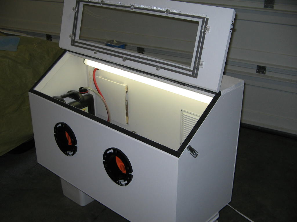

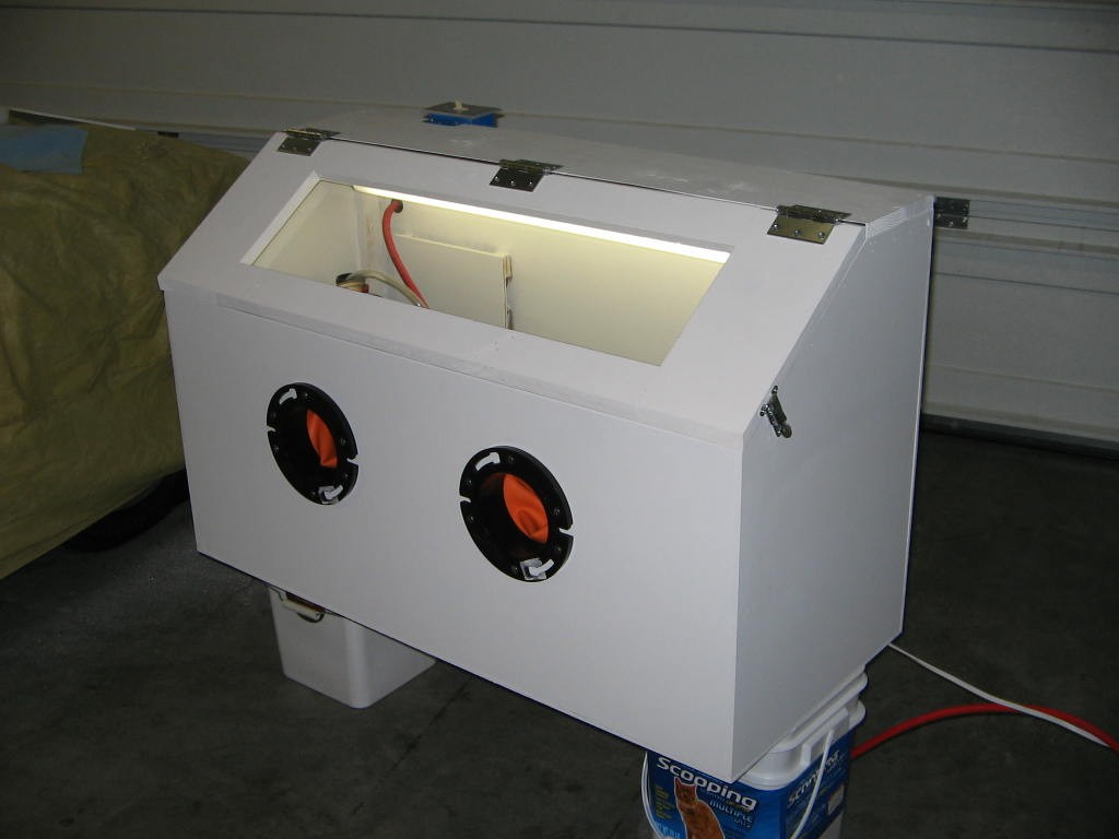

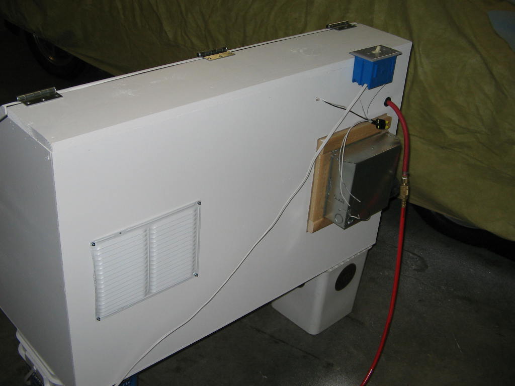

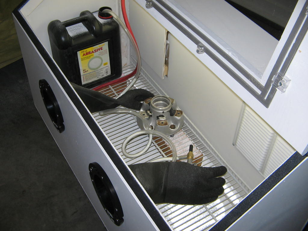

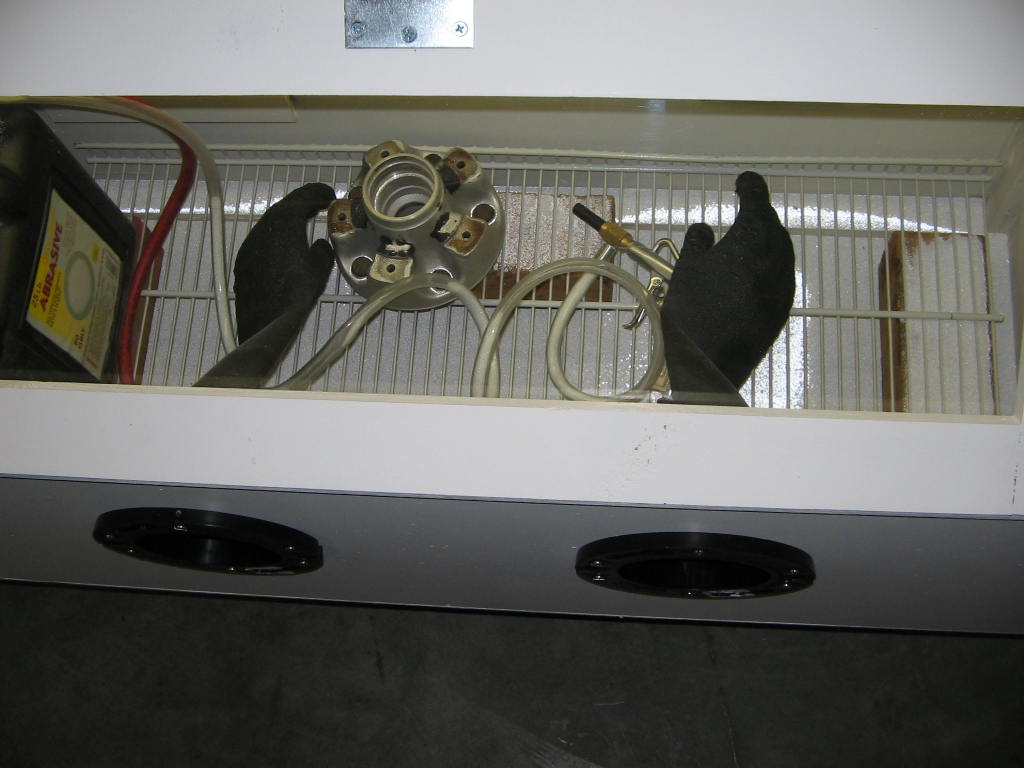

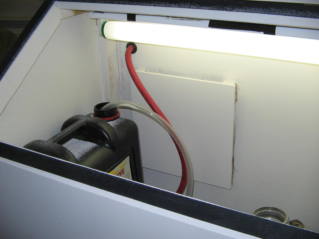

Here's my home made blasting cabinet. I just finished it tonight. (IMG:style_emoticons/default/biggrin.gif)
I'd been wanting one for awhile. I recently bought an original muffler that has surface rust, so I wanted a cabinet that would be long enough to fit an entire muffler. $$$
I went ahead and made one with materials from Home Depot, Ace Hardware, and a cheap gun from Harbor Freight. I tried it out tonight and it works great! Obviously, it has no hopper, so I'll have to stop after awhile and shovel out the used media. On the back is an inlet and a bathroom fan for an exhaust. I have a filter in the inlet so no dust escapes. The exhaust fan makes for a nice negative pressure atmosphere in the box. I will hook up a hose and exhaust the dust outside. If it's a lot of dust, I will run the hose to a home made filter box. I realize that dust may shorten the life of the exhaust fan, but it's cheap and replaceable.
There is a 36" fluorescent light inside. I have it wired so that the light and exhaust fan come on together. I can't wait to do some more blasting!
Next step is to build a stand for it this weekend.
